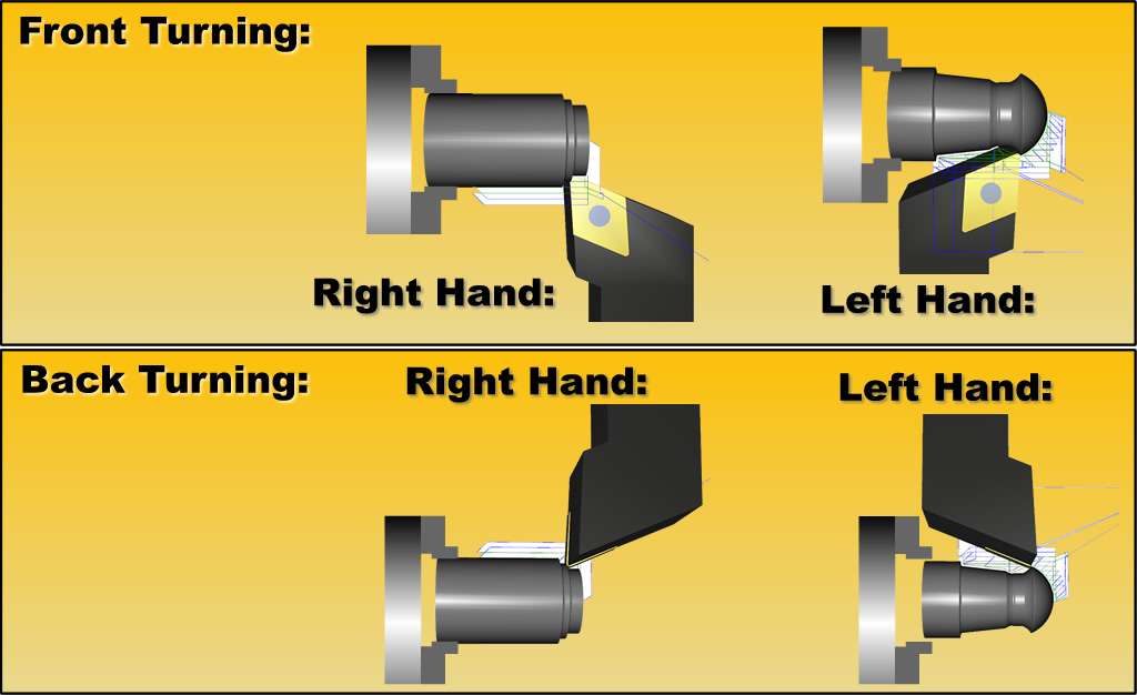

Re: Tool Orientation
This should clear up which is Left hand or Right hand turning tooling:
Left or Right handed turning tooling
