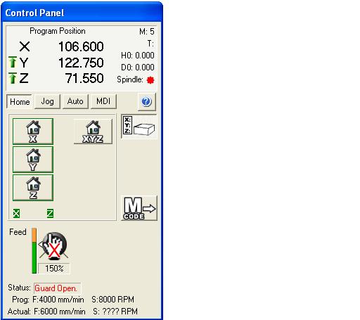

Can you download the lattest version of VR Milling 5 and run that.
Next time you have the homing problem abort the procedure with the Esc key.
Then with the software still in the Home mode press each home switch in turn. The axis is displayed in green at the bottom of the positional display window when the switch is actuated if the switch is functioning.
If the switch contacts are jammed open with dust the axis letter will be displayed constantly (and the axis will move away from the switch slowley when you send it home).
The best way to clean the switch is to put a vacuum nozel up to the switch then manually operate the switch.
If you just use an air line or vacuum without operating the switch you will not clear the dust as it is trapped between the contacts.

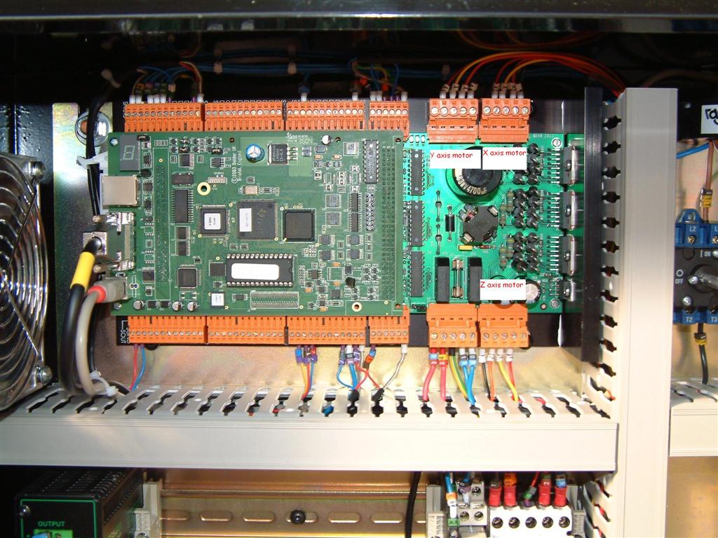

If the read outs are incrementing when you try to hame then it may be that the the fuse that on the Nextstep bottom board has blown, it is shown to the Left of the "Z AXIS MOTOR" inset.

Hi Steve, am with Team Bio-Hazard, Menai High, Australia. I'm Ian one of the supervising teachers, Mike is the other, and is currently off doing the itinerate marking for the Industrial Tech. HSC practical work. It's getting on towards 10pm as I write this, will try to have a look at things again tomorrow (Saturday), pretty busy though, 5 days before we leave. Thanks for the photos, gives me a better idea of what's what on the boards. Talked to Daniel Bryan-Curnow of REA who gave some suggestions. Have found that while the computer thinks the axis is moving, can trip the home switch manually and the display will indicate that it has homed. All this started just after using the E-stop to halt a spigot clash. Haven't thought to listen for the relay drop out but have noted that the E-stop is displayed on the control panel and it does disappear after the E-stop switch is re-set. Used the E-stop to halt the apparent homing routine after the distance traveled on the Z-axis exceeded 600mm. If I get the chance tomorrow will try to check it out. Home to catch up with at the comp. All the best.

Yes the drive fuse is the one pictured. It should be a 6.3amp semi delay 20mm fuse.
