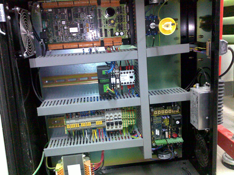

i think it is fuse no. 1, it is located on the top most of the black box. First thing what i did is i unplug the big main power that connected to the microrouter with the fuse 6.0A. Then turned on the power, the fuse looked ok at first, then i turned it off and was connecting the power to cnc machine which then fuse blown. I think it must be spindle. but i have no experience to fix spindle. Btw i did not connect spindle motor during this test.

Please send a photo of the Electrical cabinet and identify the fuse that is blowing.
Press in the E-stop button and power on the unit.
The 7 segment display should light on the Baldor control card. The fuse should not blow.
Then release the E-Stop, this should apply power to the axes drives if one of the drives is at fault the fuse would blow at this point.

Martin wrote:Is it Fuse F1 on the Denstep control card? (above the orange connector plug & mounted on the PCB)
yes martin, you are right. It is fuse above the orange connector.
If it is then inspect the transistors monted on the heatsink for damage. You sometimes see a hole or crack in one if has blown. Fuse F1 on the Denstep is the Axis Drive Fuse & should be a 6.3 amp fuse.
where is the heatsink located? sorry I really confuse seeing this pcb board.

Here is the pictures. The fuse is located on the red circle.

Steve, what you are saying is correct.. the fuse blow just after release E-stop button. Then what else I need to do?
