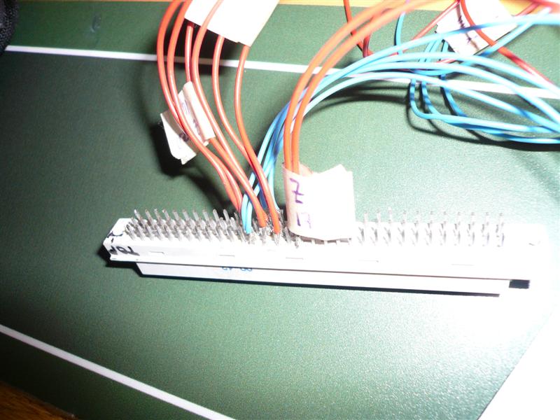

A connector we made a long time ago for controlling the bottom board stepper motors. (I'm pretty sure we used an opto isolator switched direct from the parellel port)

anyone have a picture of the orientation of the 96 pin junction on the board? which side is top, which are rows a/b/c.

Best described by a photo:

perfect thanks!
