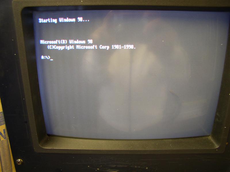

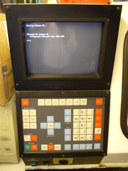

I have now created the boot disc after getting hold of an old windows 98 laptop, the mirac seems to boot up ok and no error codes.
But thats as far as it goes (see attached photo's) do I need a seperate keyboard or pc?

Re: Mirac installation software
You now need to create a "autoexec.bat" file on the floppy & insert the name of the software on the first line.
. May be easier to create it back on the Windows 98 pc. Have a look on the floppy disc as to what the "exe" file name is. I presume it may be "mirac" or "flstep" but the sutoexec.bat file needs to have whichever on the first line.
The other option is to plug a qwerty keyboard in to the socket on the side & sinmply type in "mirac" or "flstep" then hit enter.
If you create the autoexec file then it will load correctly each time you switch on as long as the disc is in.

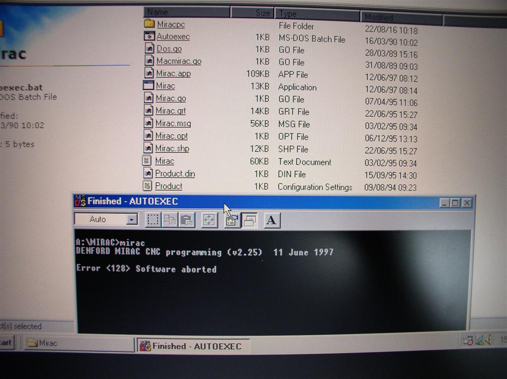

Thanks for the speedy reply, I have checked the autoexec file and it seems to have mirac ion the first line, please see attached and maybe you can tell me if this is correct
Jon
Below is the original "mirac.opt" & "mirac.go".
You will need to amend the files on the floppy to match.
