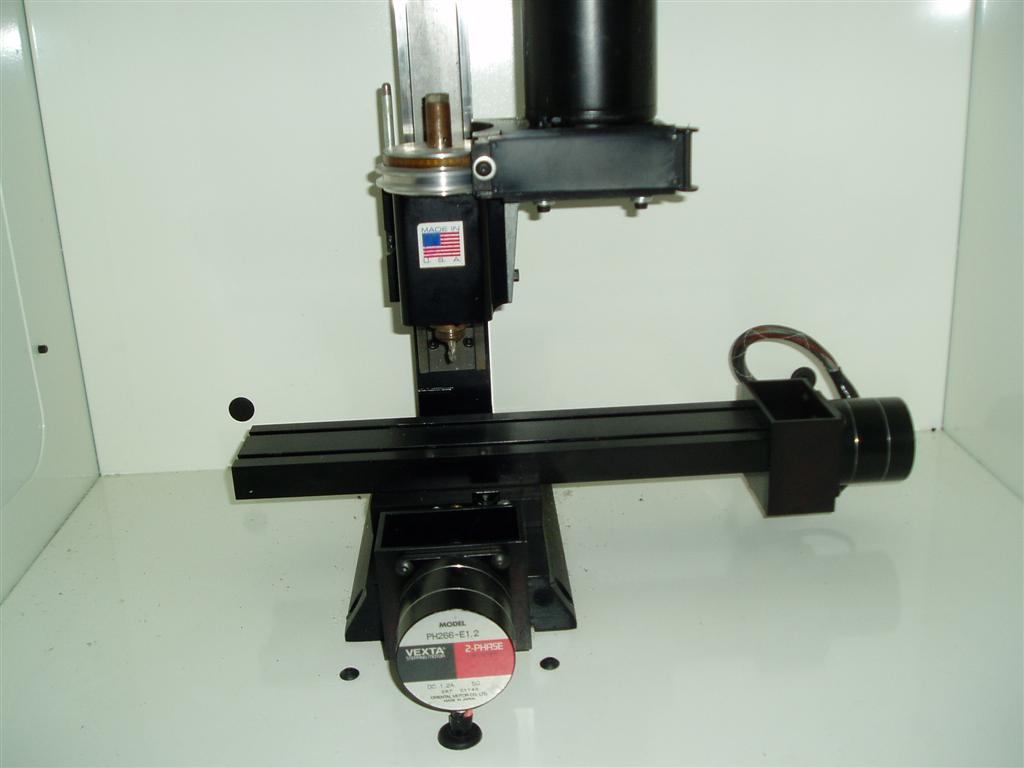

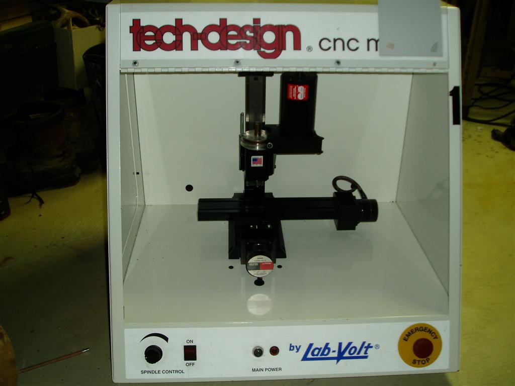

Attached is a photos of the mill.

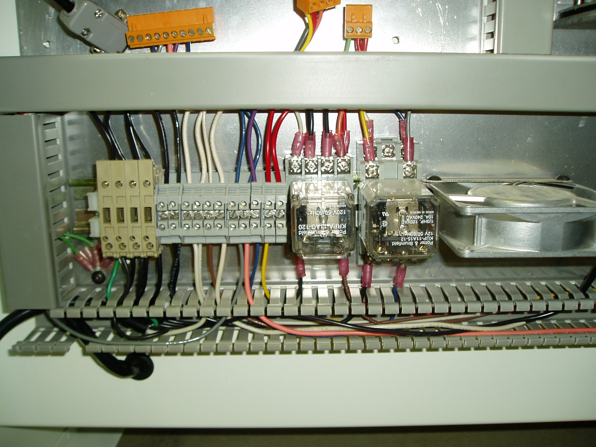

From the look of the photos I suspect this machine is one we have built for an OEM distributor.
A full photo of the front and back would help. I suspect its a machine badged for LabVolt?

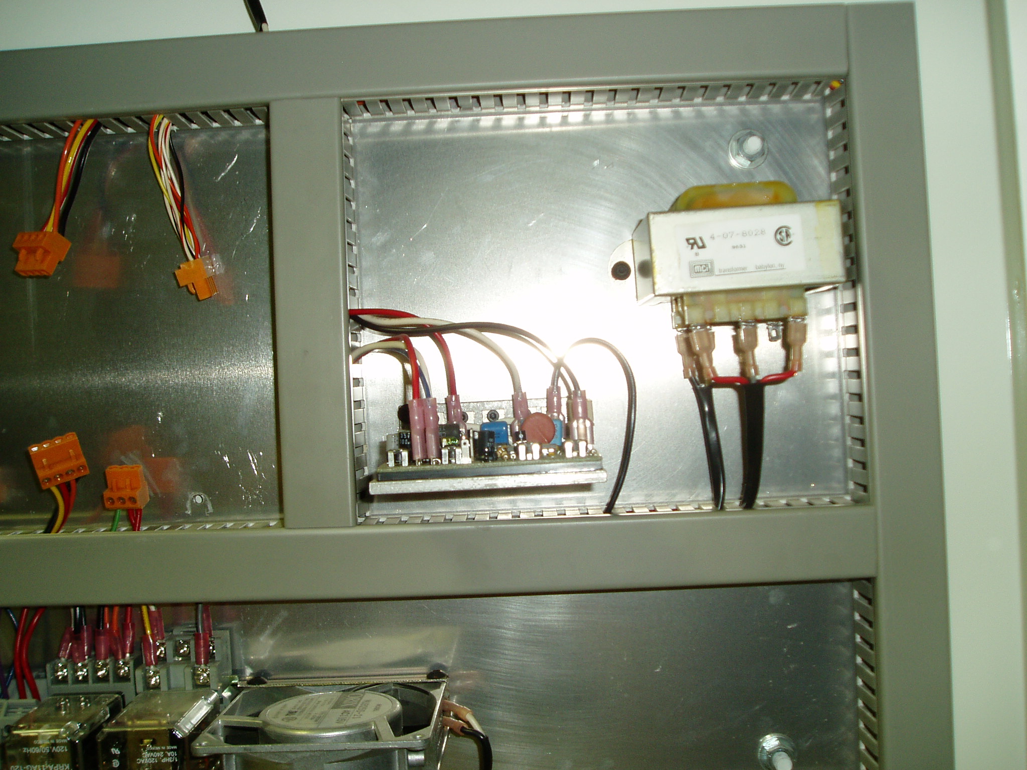

The electronics in the back was designed to support the Smartstep control card.
Upgrading to a newer control would require a rewire but also a larger transformer as the one fitted is too small to run the upgraded card.

All the wiring is correct for a smartstep control card.
It looks like when the card was removed the unused connectors were left on the card.
Replacing the unit should be straight forward if a smartstep can be found with a DOS EPROM fitted.
