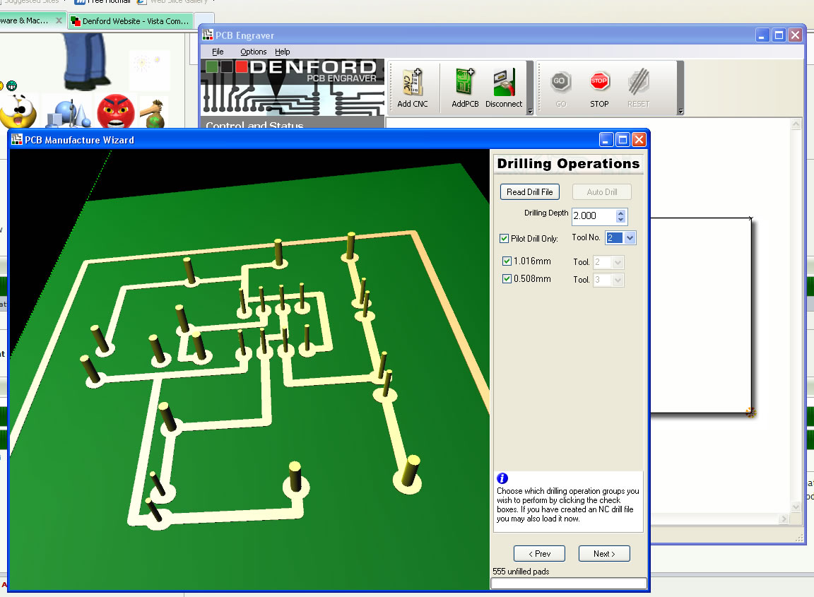

Instead of reading a drill file, try outputting the gerber with un-filled pads where you want to drill.
The software recognises these and will automatically pick out the drill sizes required.
(See attached)

Thanks, that would be the easiest way, but the Eagle CAM processor "Fill Pads" box is permanently checked, and greyed out.

According to the Eagle forum there is no way to produce Gerber data with unfilled pads.
