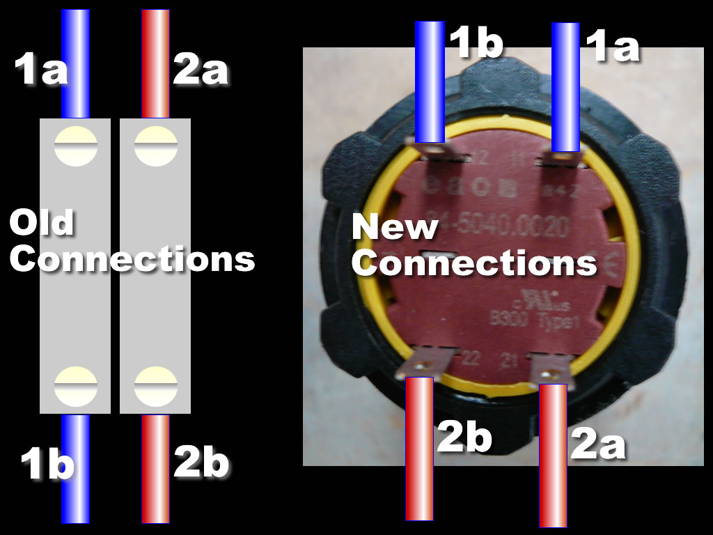

We have an old Microrouter Compact and need to replace the "old style" Emergency Stop Switch with the new style Emergency Stop Switch that has 4 prongs. Please tell us how to switch out from the old style to the new style. Thank you.
Keep the wire pairs together (which are connected to the same block) - if there is more than one pair on the old estop (?)
Then wire them to 11-12 and 21-22 as pairs.
It does not matter which wire of the pairs goes to 11, just as long as the other wire of the matching pair goes to 12
