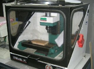

I would appreciate some photographs to confirm which model I have.

My Starmill (starmill pc) is a newer model. Picture attached.
Any further detail welcomed.

starmill pc0001.jpg (83.77 KiB) Viewed 15734 times
What is the version number of the Eprom on the main control card inside the black electrical cabinet?
It`s the card with the 7 segement LED in the top left & all the orange connectors.

The version number is 2.1 and the information on the outer case plate is
as follows:
Serial number 50119 - 1
Date Feb 1995

Version 2.1 is a VRMilling Eprom.
The normal software for this would be VRMilling Ver2.31 which you can download from the Denford Website. However it will require a software licence to enable it. Did the floppy disc with the VRMilling Licence come with the machine?
