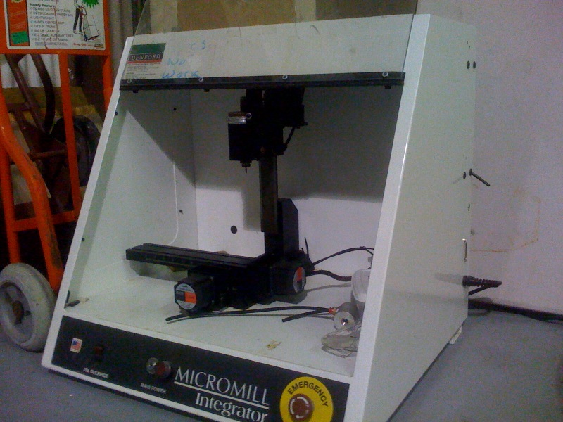

I purchased a used Denford MicroMill "Integrator" and I don't think
it's coming with software, and the condition of this thing (working?) is
questionable - how do you recommend me testing this thing(the
electronics)???
And, could anyone give me a good summary as far as what software I need to use this machine successfully.?..

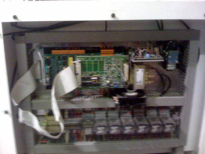

We'd have to see pictures of the black box - this machine could have any type of electronics fitted (either by us, or by someone who has retrofitted another system like Mach 3)
Bad picture of the black chassis
thanks for your reply, I've included some photos of the system.
Electronics
Electronics
Integrator cabinet
Integrator cabinet

as for which software, what does it say on the eprom which has a yellow label on it ? at the top of the box, behind the daughter board which has a big ribbon cable coming out of it.
Yellow label

Got the # off the chip.
The Yellow tape label has the following:
denMINT
2.0.B10/S/B19-JD5
Bar Code (board) OC00193067
The main driver board, says SMARTSTEP/3 (OC00197356)
The main driver board has 8 orange screw terminal/connectors (if that helps ya)
There's also another third card that sits above the main board, and the controller card. This board said "OPTIMISED CONTROL LTD (issue 2)..

You will need VR Milling v2 to run this machine.
Bit of a grey area here though, because we no longer support version 2...
I'll pass it on to our US office to contact you
