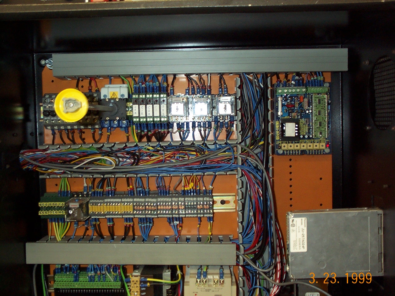

I wonder if a photo of your cabinet whilst the power is on may help ?
I could have just label it wrong but I'll get some pictures today
Here are the picture the Seven segment display read and 8.
control box
control box
lower half

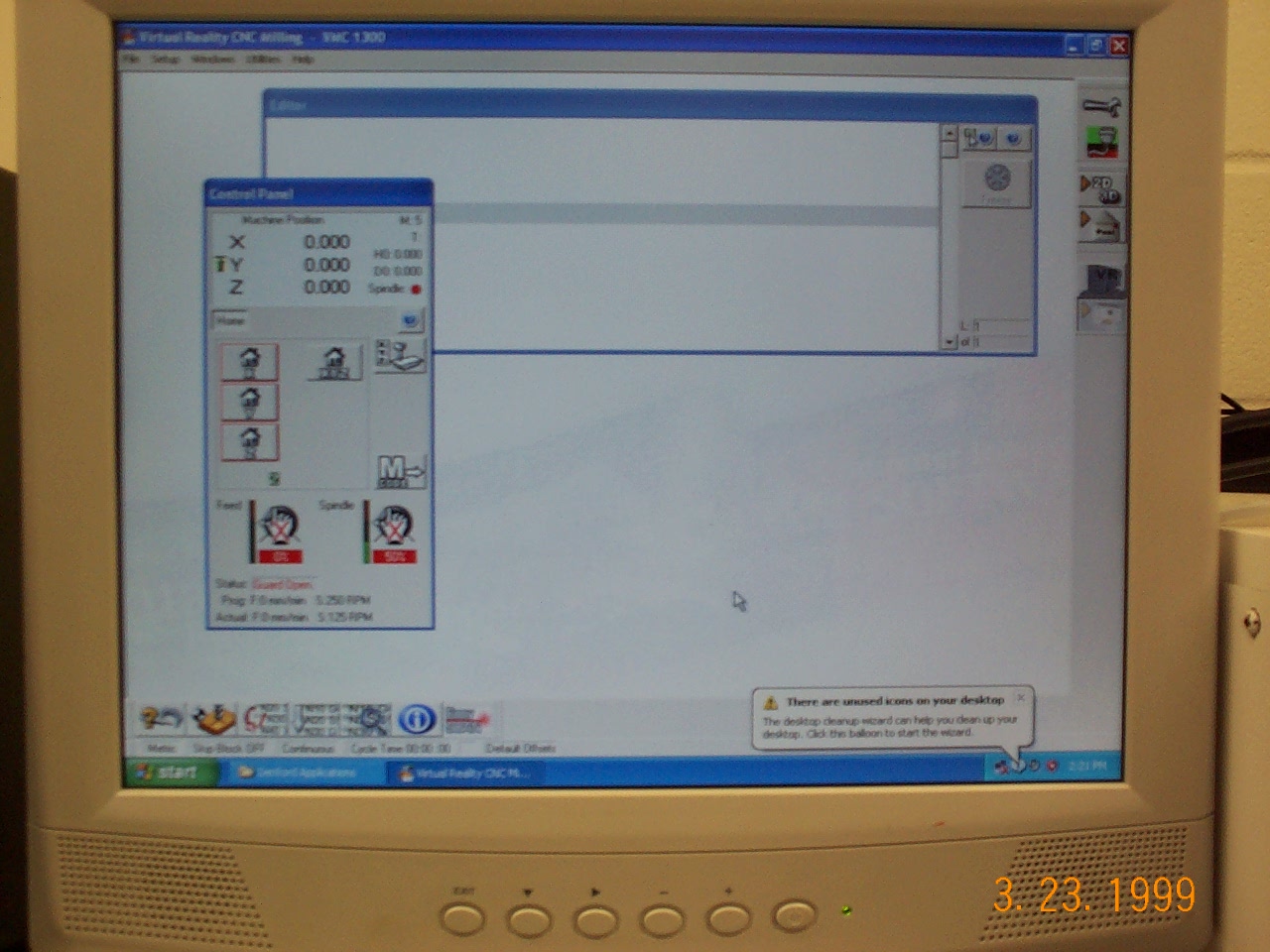

screen shot
screen shot

First thing to do is select TRIAC VME from the menu:
Setup > Select Machine...
See if that fixes things
We tried that, that option is not available.
Can you install the latest version - TRIAC VME is definately there and should be the one to have selected for your machine.
VMC 1300 is a completey different machine
VR CNC Milling v 5.26 (120Mb)
https://www.denfordata.com/downloads/VRMilling_V5_26.zip
nice catch, I'll reload the software.
It can be hard to match the machine type to the software sometimes.

I tried changing it to Triac VME with loading it with ALLOFFSETS.MOF and with default setting. Still nothing moves. It recognizes if the door is opened or closed or if the EMO is pressed but still nothing moves
Also I don't know if it is different but our machine says VMC
Have a look at the three fuses on the backplane just above the axis drive cards.
Can you see if the x axis ballscrew has power to it by manually turning it with the E-Stop out & in?

It may be worth removing the two cards in the rack marked Euro Card & Custom Card.
Then make sure the ribbon is clamped in at both ends & then refitting.
It sounds like it is a bad connection either to the back plane or via the ribbon cable between them.
