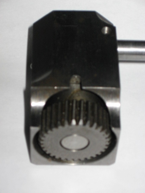

The gear on my metric one has 30 teeth and, as you can hopefully see in the attached pix, it covers a wide range of metric threads.
Hope this helps,

My picture doesn't really show that there is only one line on the top of the metric indicator - i.e. there is only one position in which it should be engaged, rather than multiple positions that can be used on imperial indicators. If you want some better pictures, PM me with your email address - I did those very quickly just to get you going.

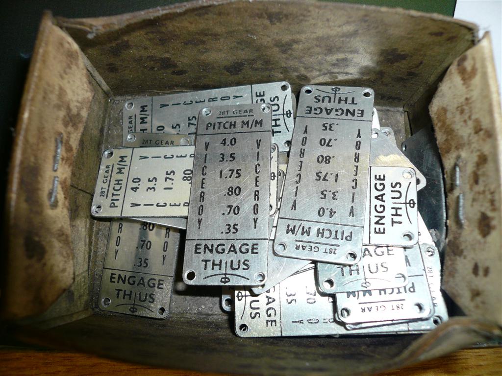

At the far end of the old DO (where the old copier is), on the floor next to the cupboard in the corner, was a box with various old charts/plates in. I know there were some english top indicators (CH246), and I think there were some metric front plates as seen in my picture.
Box full of mm ones - can't find any english (unless I'm looking for the wrong thing?)

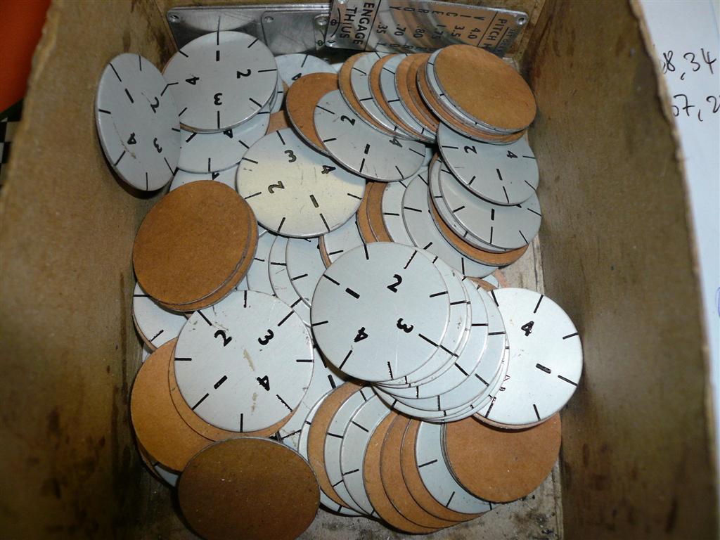

The 'english' ones I referred to were the disks to go on top of the indicator - 1" diameter with 8 marks and the numbers 1-4 - as shown on drawing ML109.
They may be in the cupboard instead.
Shame there aren't any 28T gears in your stores to go with the plates you found!!
et voilà...

Whilst looking through this posting, I saw that although I have had a TDS1/1 for many years The thread indicator on it has 30 teeth and that to cut the full range of metric threads, I would need another wheel with 28 Teeth.
OK so I will make one..... But I was surprised to see that on the Drawing supplied by ADMIN, the tooth size was given as 26DP. My question is this . Why Would a wormwheel that is intended to mesh with a METRIC lead screw be given as a DP size rather than a MODULE size ?. I would have thought that it should be M1 which would work out as DP 25.4 !!!!

Re: Dial Thread Indicator Information Plates
Denford Admin wrote:Box full of mm ones - can't find any english (unless I'm looking for the wrong thing?)
PM me your address if you want one posting
Hello Admin
I am making a couple of Dial Thread Counters for Metric Threads, Could you post me a couple of 30 tooth and 28 tooth information plates as shown in your photo showing a box of them?
I will PM my postal address.

I have made a couple of 28T gears to fit my Viceroy TDS 1/1 GB (Metric) Dial Thread Indicator, as per original specifications and made from Meehanite Cast Iron as per original. I have tested them and they work perfectly, engaging accurately and allowing the counter to be used for the other metric threads e.g. 1.75 thread (12mm) etc. With the spacing collar the right length, it engages exactly on the marked line.
