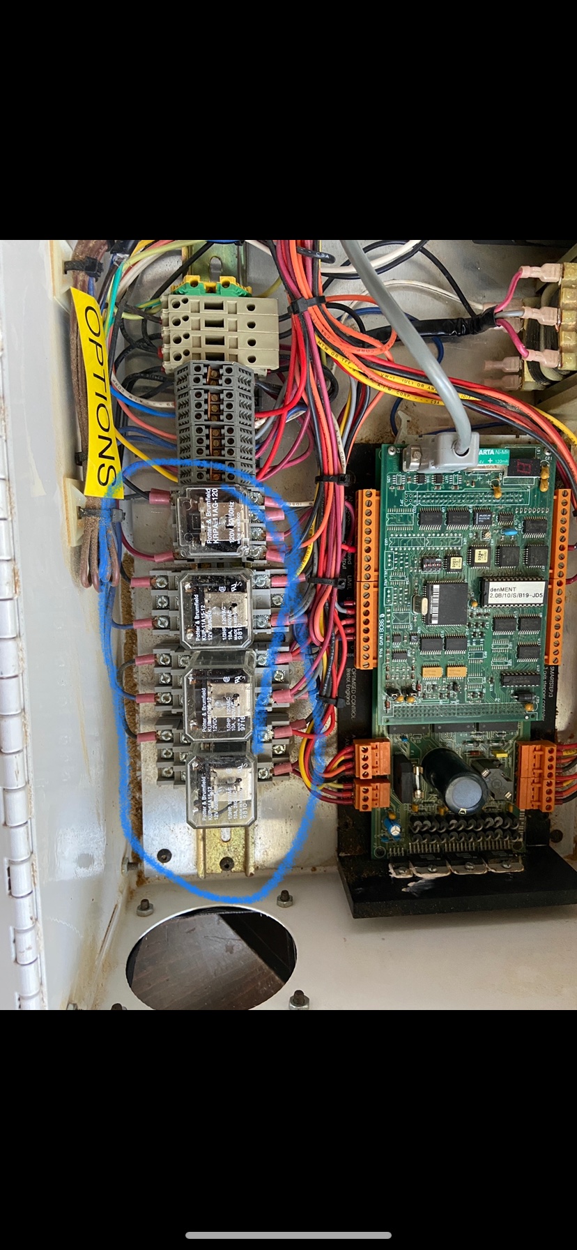

I have the same problem with mine . Are any of these the relays for the E stop ?
