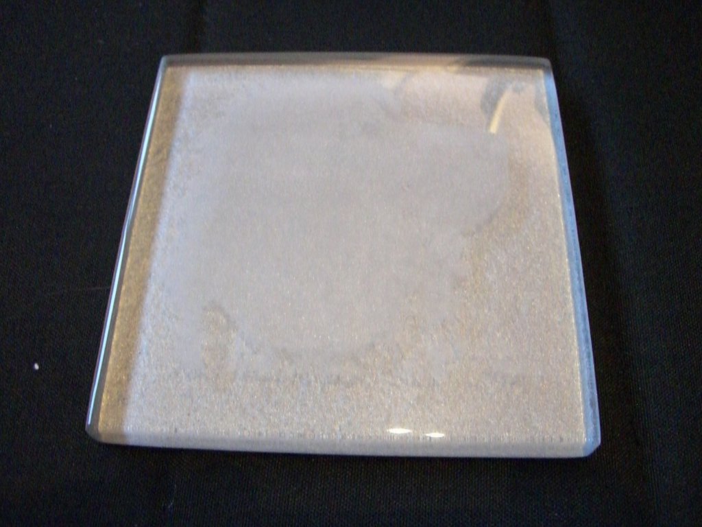

Here are a few shots. This is a 100mm glass tile, with a silver backing. The engraving was done on the top surface. The picture is of a spaniel's head, which you can just about make out in the oblique view.
glass1
glass1
glass2
glass2
glass3
glass3

I'm sure you can get a better result by modifying your original image in Paintshop. It looks like there is no detail within the dogs head, so you need to adjust brightness/contrast levels and convert to black and white.

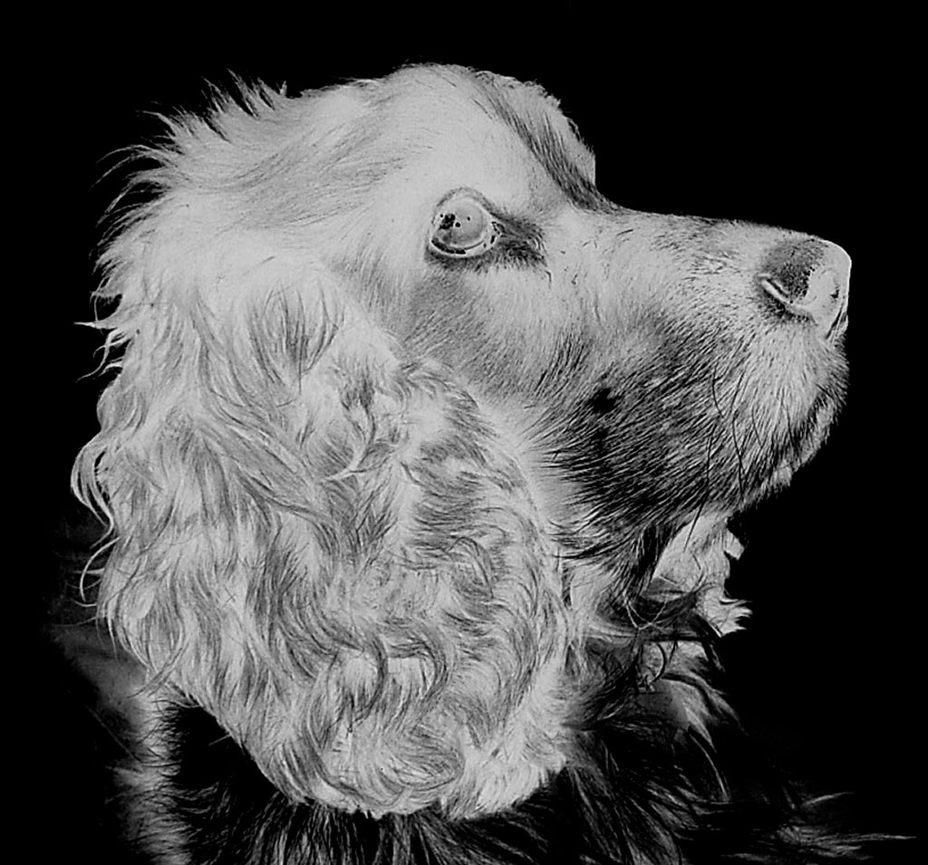

Thanks. I'll read through and try again. Here's the source image, which we thought had enough detail.
