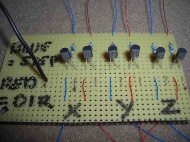

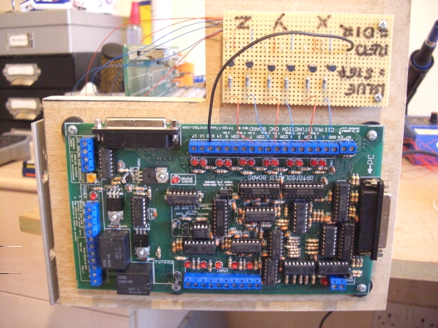

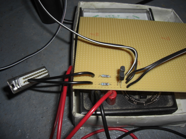

I just received my order from Maplin of the resistor's and transistor's (see Jpeg I've upload ) I'm going to have a go at making some kind of board to tie in directly onto the motherboard. I will post my success or failure's on how I get on.

I've soldered up the transistors and have checked with a multimeter what is going on with this circuit. I've put 5v in and I'm getting out just a wee bit less 4.9v I am not sure what really going on with this circuit. I'll hook it up to my z axis and give it ago this weekend and post my results.

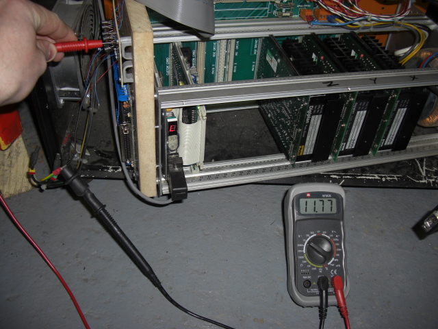

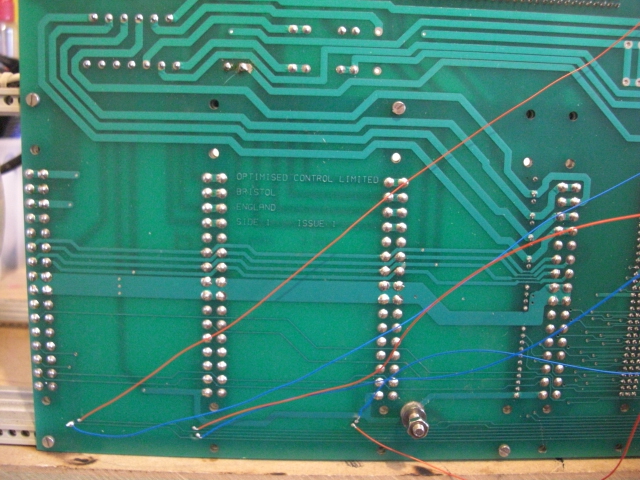

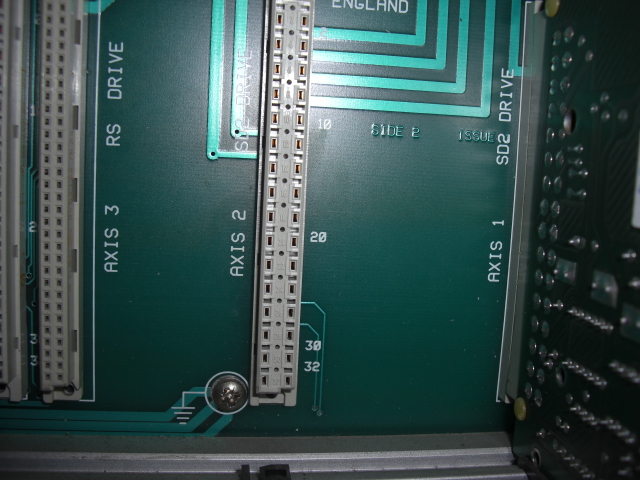

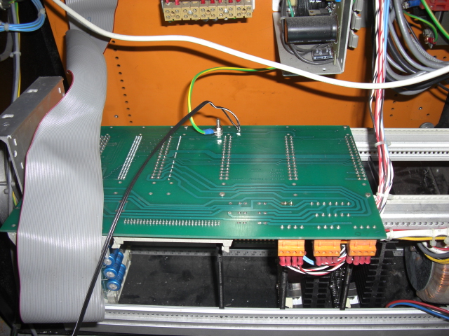

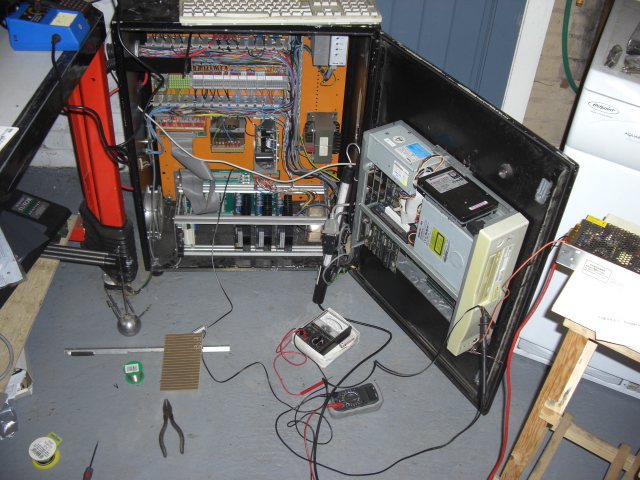

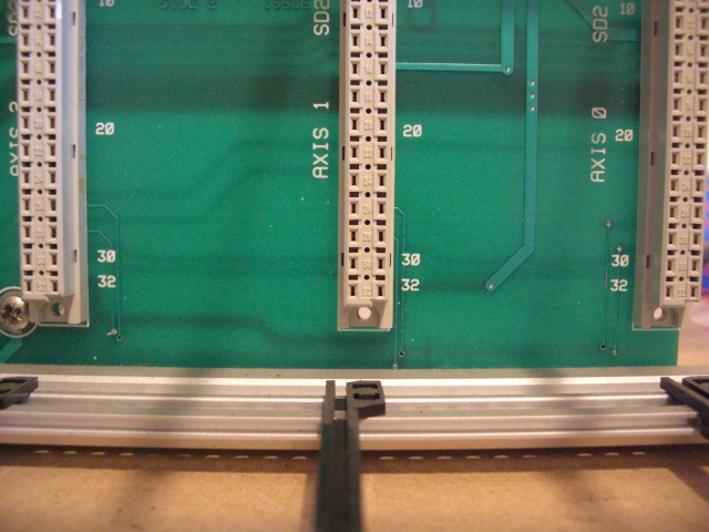

Just an update of where I'm up to so far. I've soldered two cables onto the back of the motherboard see photo's 2 and 3. On photo 2 I've removed z axis driver card. you can tie the step and direction by using the two small holes below the numbers 30 / 32. This can be repeated for the other axis.
I then powered up my machine and using a 5vdc power supply touched on pin2 on my 25D connector the motor pulsed one step then I added 5vdc to both pins motor moved in reverse. I keep on playing around and in the end nothing was happening.( I maybe have fried the transistors) I got the motor moving again by touching 5vdc directly to the cable's I soldered onto the motherboard. I've just ordered a C11 board from cnc4pc. I did not connect it to my pc and test with Mach, I'll wait for the new breakout board as this is opto isolated.

Home made circuit board

Just an update on where I'm on with the conversion, I've uploaded some new photo's. I've soldered step and dir cable's on to the back of the motherboard which are connected to the homemade voltage amplifier circuit, which is then connected to the BOB. Well how did I get on, The first time I switched on the motors they were jumping around and slowly creeping. Turned off and on machine control and this time motors quiet and no jumping or creeping. I tried to move the motors under mach I got nothing on x and y but I did get movement on z but only in the minus direction. I couldn't tune the motors, no matter what setting I tried the motor only turned slowly.
I have asked on yahoo answers about the voltage amplifier circuit and they have replied quoting that the circuit is too simple and would not amplify 5v up to 12v. I think this is my sticking point if anyone can help with this issue I would be grateful.
Motherboard with driver cards removed
motherboard with driver removed.JPG (256.7 KiB) Viewed 73630 times
Back of motherboard where I have attached step and dir cables
back of motherboard.JPG (286.79 KiB) Viewed 73630 times
Cnc4pc c11 card with homemade circuit
cnc4pc c11 card plus homemade circuit.JPG (305.2 KiB) Viewed 73630 times
Hi Dale,
The drive board should work ok, providing you have it wired correctly. Mine works great on my triac with digiplan drives and the same breakout board as you.
Just looking at your board (you may have it correct but i can't see it well enough). The ground pin on the transistor should be the right hand one if looking at the transistors flat face.
To get my steppers to run smooth I had the dir active low and step active low turnt off, and motor tuning with 200 steps.
Cheers Roy

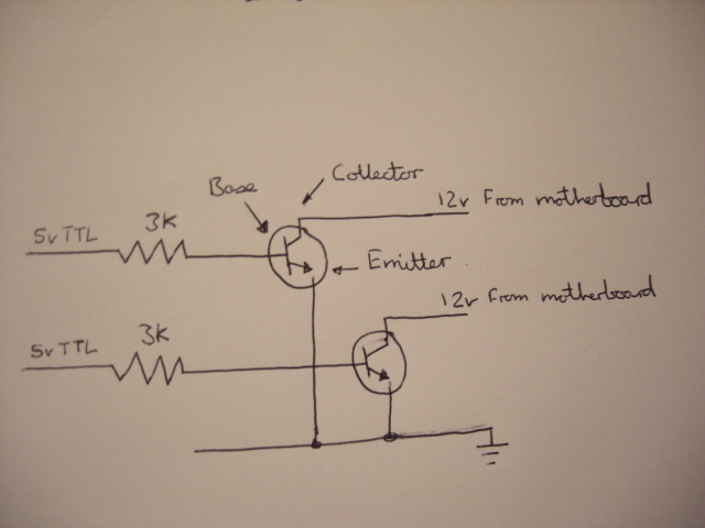

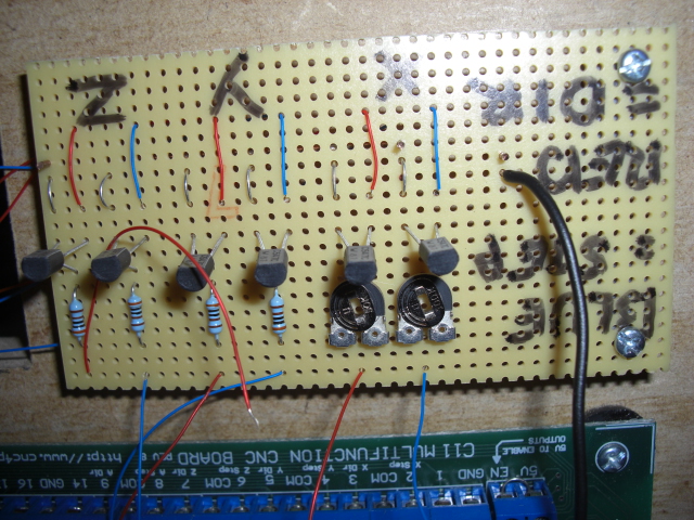

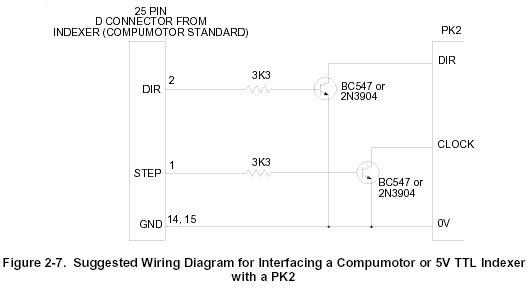

Thanks for everybody's reply. Roy I do have the ground pin as you pointed out thanks. Simon I disconnected transistor circuit form BOB and measured voltage on all drives both step and dir and the reading range from 11.5 to 12v. I've then connect up x axis to BOB, motor is quite when dir is active high but when I change dir 0v motor is noisy and stays nosey until I change dir active high again. I've checked the volts coming from the BOB( transistor circuit disconnected from BOB ) dir = 0v-5v but step is only outputting 0v-1.25v. When I check then volts @ the collector end of transistor on dir I'm getting 8.8v when mach is outputting 5v and when mach outputting 0v I'm getting 11.7v. On step @ collector end when mach outputting step and dir signal =9.7v and if only outputting step volts = 11.1v. I've uploaded a wiring diagram of the transistor circuit I've made to see if it's correct. Is this transistor circuit acting as a switch to alter 12v to 0v from motherboard when receiving 5v from BOB? Hope this information can help with tracing my problems
close up of transistor circuit.JPG (276.24 KiB) Viewed 73594 times
feed from motherboard.JPG (266.8 KiB) Viewed 73594 times
circuit diagram.JPG (170.84 KiB) Viewed 73594 times
Dale
give me a ring or call on skype if you have it etc , and i'll see if we can work through your problem
i think you may also need a pull up or pull down resistor from the base of the transistors to +5v or down to 0v depending on the logic of the ttl input
the transistors may not be fully switching
regards
Dave
The transistor is obviously not turning fully on.
It's strange that your step & dir outputs are showing different voltages!
Is it possible that the step output is pulsing (switching on and off v.fast)? On mach, try swapping the step & dir outputs and see if the voltages shown reverse as well.
A transistor behaves a bit like a dimmer switch on a ceiling light where the knob it 'turned' by the current flowing from the base connection to ground.
The virtual ceiling light is connected between 12v and the collector.
With your setup, the dimmer is only being turned 1/3 of the way round - and the 'light' is not bright enough to operate.
Transistors have an associated gain - which means that the amount the 'knob' is turned for a given current flowing between the base and emitter. differs from one type of transistor to another.
I suspect that the transistors you are using do not have enough gain to pull down the step & dir inputs close enough to 0v to operate correctly.
I would try changing the 3k resistor for a lower value. That will allow more current to flow from the base to emitter - which in turn allows more current to flow between the collector and emitter.
Try 2.2k then 1k.
The transistors you are using are BC547C which quote a gain of 420
This means that, with a 3.3k resistor, it should allow 600mA to flow from the collector to emitter - which ought to be plenty.
Try connecting your meter, set to mA between one of the step inputs and 0v - this will give an indication of how much current needs to flow through the transistor to operate the board.
Let us know the result.
Si

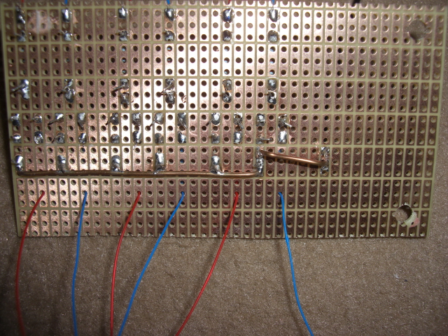

Hi guys, thanks for your continuing input. I have uploaded a new photo of the alterations to my circuit board I added two wiper resistors to find the best resistance, I adjusted to 2k to start with, I switched on machine not much difference adjusted down to 1k and x axis moved in one direction but I also noticed z axis was moving at the same time but the z cables were not connected to the BOB. So I connected the z axis cables to the BOB and I got movement in both directions on z axis ( movement is slow and does not responded to motor tuning) I then moved the earth from the emitter on the transistor circuit from BOB pin 15 to machine cabinet and I got movement on x axis in both directions. I'll upload a photo of the back of my transistor circuit which shows how I connected all the emitter side of the transistor together which I connected to pin 15 on BOB but then I moved it to the machine cabinet. Is this incorrect? ( I tried moving emitter side of the transistor to different earths which did have an inpact on noise )
wiper resistor.JPG (328.04 KiB) Viewed 73498 times
back of transistor circuit.JPG (366.36 KiB) Viewed 73498 times
Well done!
Sorry - should have said that the BOB, Transistor and Stepper driver all need to share a ground.
Si
Bingo!!!
After a stressful three weeks the Motors are zipping along except y but I think thats just a bad connection on my transistor board. Only had a small amount of time to play with the tuning. I've doubled the z speed to 2000mm/m and x is running @ 2500mm/m. Big thanks to simon and everybody else who contributed. :lol:

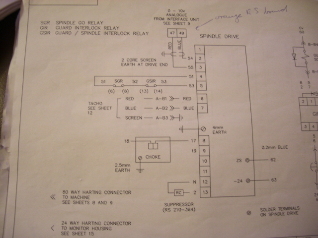

Just an update of where I'm up to. Fixed Y axis by replacing a transistor. All axis are now running well Z axis 2000mm/m, X axis 2750mm/m and Y axis 2500mm/m with acceleration greatly improved. Next I worked on the spindle, using one of the onboard relays on my BOB I bridged cables 53 and 52 ( take care as I did get a shock I think it's 30vac ) and removed SGR see photo. I then enabled spindle in Mach, typed in M3 in MDI mode spindle switched on and even rotated at around 30rpm, so far so good. Next I re-used the power supply of the old pc to supply 12v to the 0-10v analogue output. I followed the set-up from cnc4pc BOB which supply setting for mach unfortunately this did not work. Basically I spent half the day try various setting altering steps and velocity in motor tuning and PWM in spindle configuration and adjusting the wiper resistor on the BOB and not forgetting step pulse on motor tuning. I was struggling to get the ratios right e.g. 10% of spindle speed = 1v and 20% =2v etc. Anyway here's my setting, in motor tuning, step 600/ Velocity 2500 /step pulse 5 and in spindle configuration PWM 3000. Next I thought I'd try and connect the 0-10v output up to spindle controller which from wiring diagram are cables 54 and 55 (see photos) first I checked volts at these cables no reading, but when I connect multi meter to 54 and cabinet earth spindle ran @ max revs and read 110v so for safety I thought I would connect 5v from the old pc power supply as a test and save my BOB. Good job I did as when I turned power on machine cabinet and no lie there was a big bang and flames from the spindle reverse relay. I turned off the power quickly and removed relay one pin black from fire but I thought I blown the whole controller, but after checking the fuses none were blown and when I plugged relay back in, spindle turned on. So this is where I need help, connecting 0-10v analogue supply to spindle controller. Any information would be gratefully received.
Dale
lenze drive.JPG (193.16 KiB) Viewed 73431 times
triac wiring diagram.JPG (203.34 KiB) Viewed 73431 times
