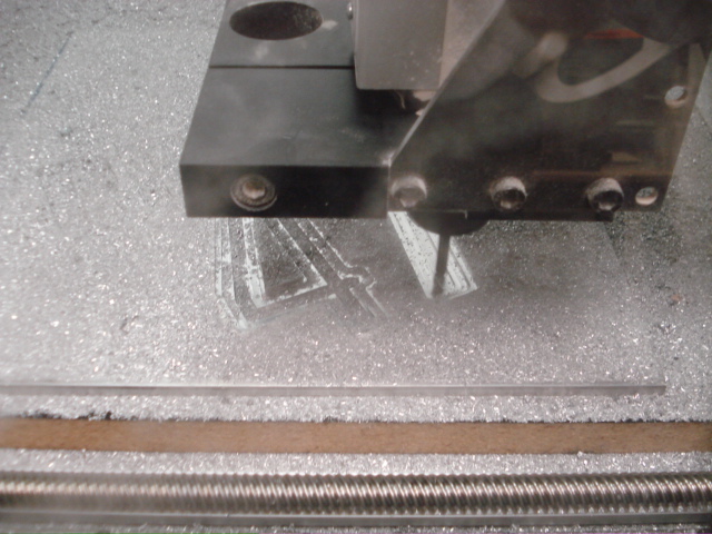

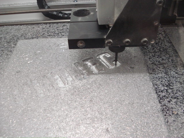

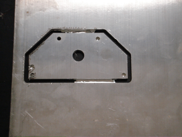

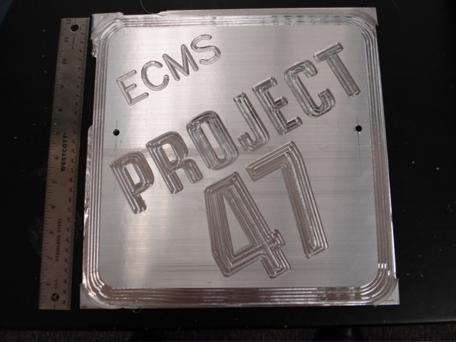

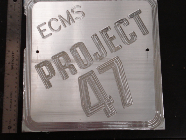

Here are photos of the Router 2600 Pro machining aluminum.
The cutter is a Niagara #85352 Solid Carbide – TiALN Coating
2-flute – SE – Center Cut – 30 degree Helix.
List #C230
The 30 degree helix cutter leaves a very sharp clean edge.
The best cut and finish was achieved with a feed rate of 8 IPM (inches per minute) and a Step down of 15% at a spindle speed of 18.000rpm.

By the way - I'm impressed by the finish you got in aluminium from a Router !
