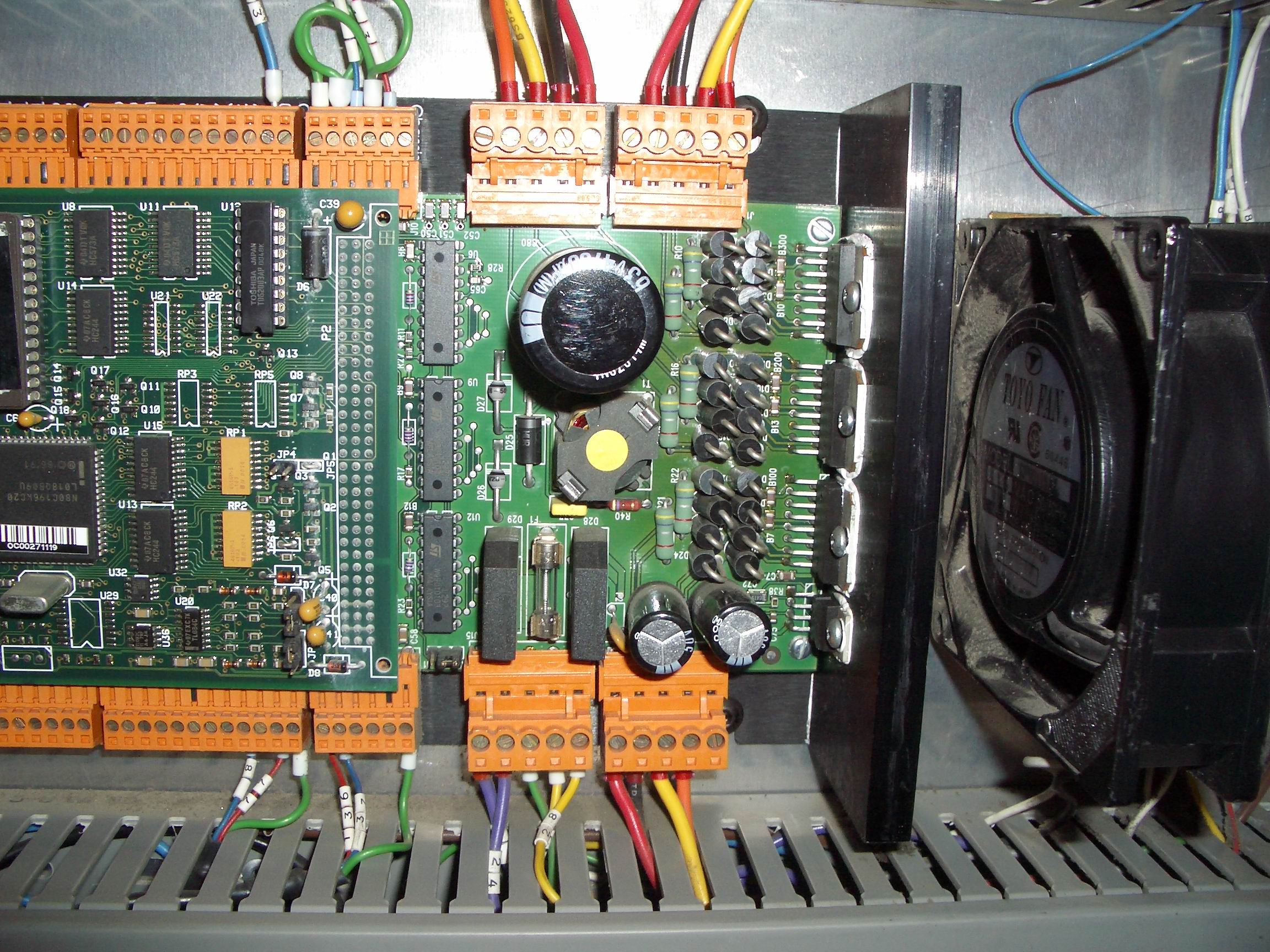

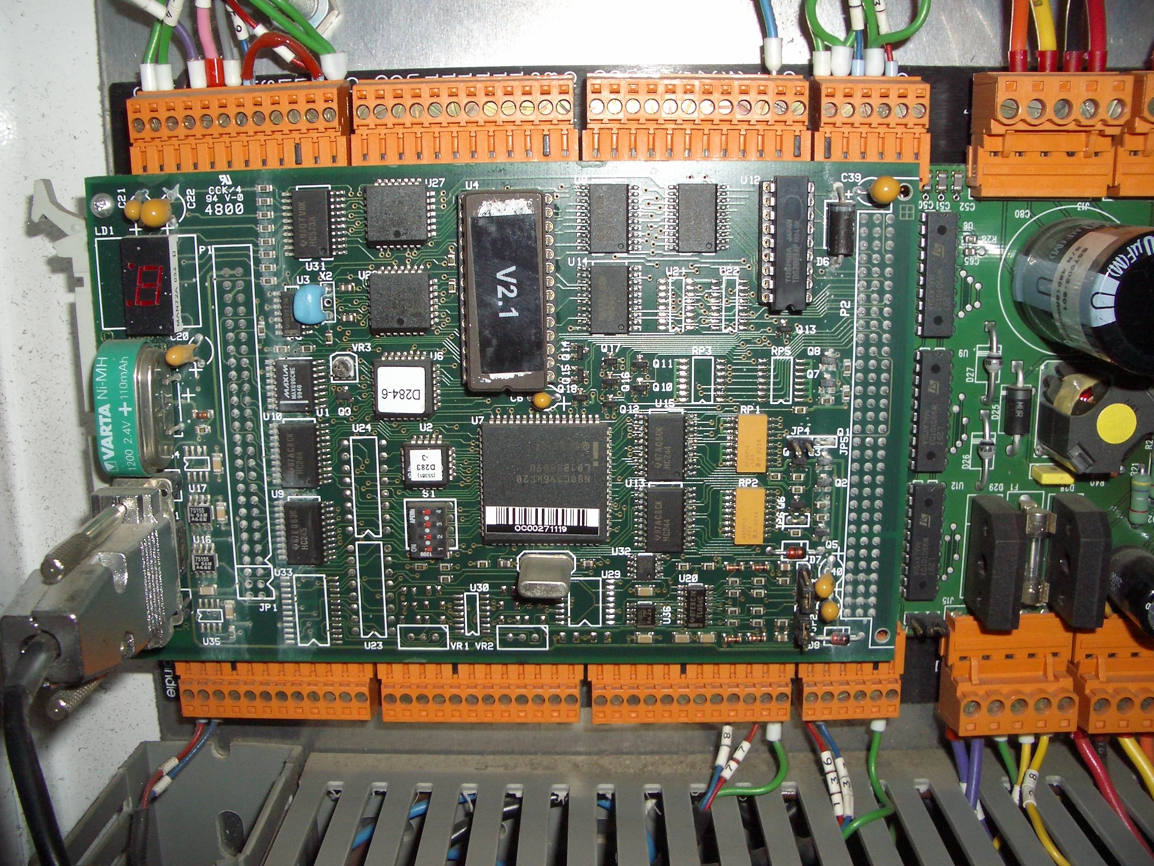

Controller
Here is pics of controller... I noticed there are just 3 driver chips !
Also the step motor wire colour is not the same on the circuit.
Denstep
Denstep
Controller
Controller

Hi Chris,
After looking at your pictures & a Denstep card in our factory, it does not support the 4th axis. I have confirmed this with Technical.
Sorry for getting your hopes up.
You can still fit the Aux`s though.
The other option is to upgrade to the USB Next Step top card with VRMilling ver 5.
Regards Martin

Hi - as Martin says, you wont be able to get hold of the 4th axis step/direction signal because the top board doesn't have the IDC header which we currently use to drive a 4th stepper drive.
However, the machine is setup by default for 2 AUX inputs and 2 AUX outputs. This snippet from the Mint may help with the I/O:
M code 62 (ie M62) REM: Turn auxiliary output 12 on
X4.0=1
Mcode64 REM: Turn auxiliary output 12 off
X4.0=0
Mcode63 REM: Turn auxiliary output 13 on
X5.0=1
Mcode65 REM: Turn auxiliary output 13 on
X5.0=0
Mcode66 REM: Wait for input 10
Mcode76 REM: Wait for NOT input 10
Mcode67 REM: Wait for input 11
Mcode77 REM: Wait for NOT input 11
Note that the outputs Sync to GND
