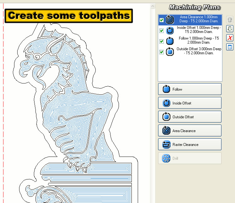

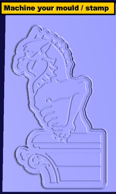

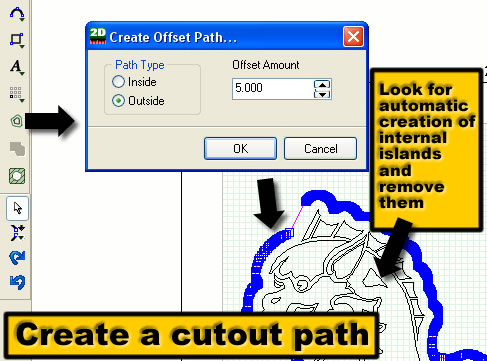

Version 1.9 of QuickCAM and LaserCAM 2D Design now have the ability to read vectors out of a PostScript or Encapsulated Postscript file.
The site www.brandsoftheworld.com is great for getting hold of your favourite logos or trademarks in EPS file format, and using them inside QuickCAM 2D to create a relief for casting moulds etc..
The following pictures show the new feature in action (note that you can also drag and drop an eps file onto QuickCAM and it will be imported)
