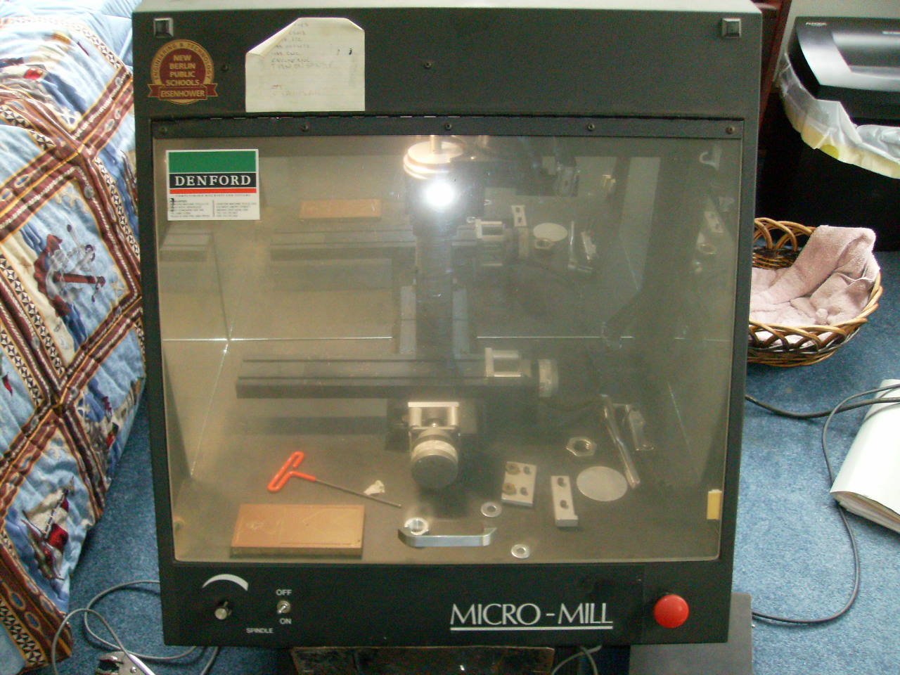

Since my machine doesnt have a serial number that i can see i included two photos. Can you tell me if this machine will run on your windows software? I notice the screen on the Denford rs232 communicator goes pink when i shut off the machine so i believe it has communication.

It appears from the exterior of the machine you may have a standard micromill using DOS based control software. We no longer sell or support the DOS based control software. You may download any of our DOS based software for free from our website

My controller is a Smart Step according to the identification link you sent. I've been working with the Dos dowload(fanucm). Can you tell me the port settings i need to communicate with the machine? baud, parity, stop bits, etc.

I don't know anything about the DOS connection but the later settings may help ? - the next generation of control (used by windows and V2 VRMilling) was 19200 Baud, No Parity, 8 data and 2 Stop bits.
I'm guessing it will be 4800 or 9600 baud for the DOS version - its also possible that the firmware outputs some text when it powers on, so you could hook it up to some terminal software and keep power cycling it .
Sorry if this is vague info - all I know about is the later windows control s/w
