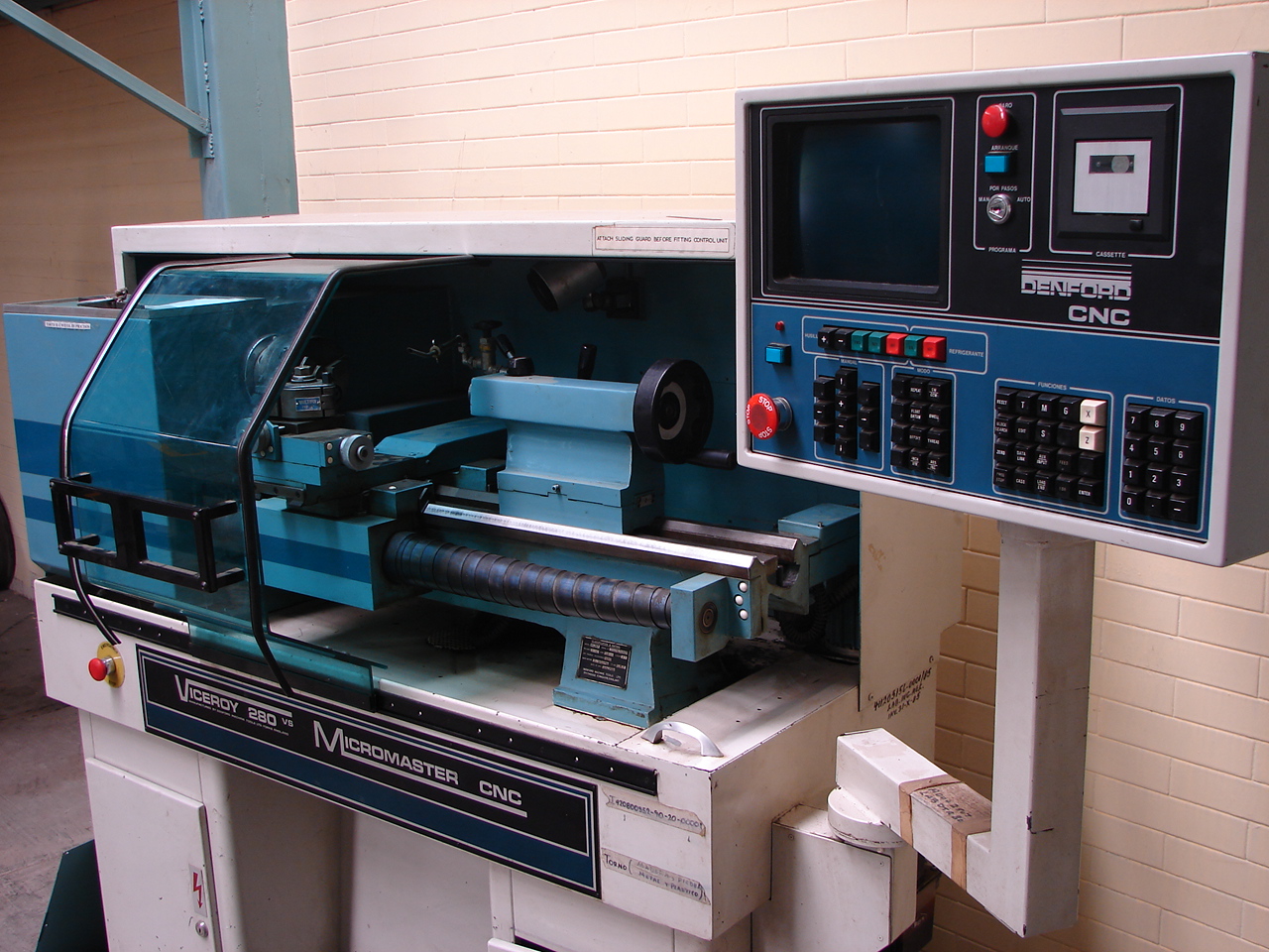

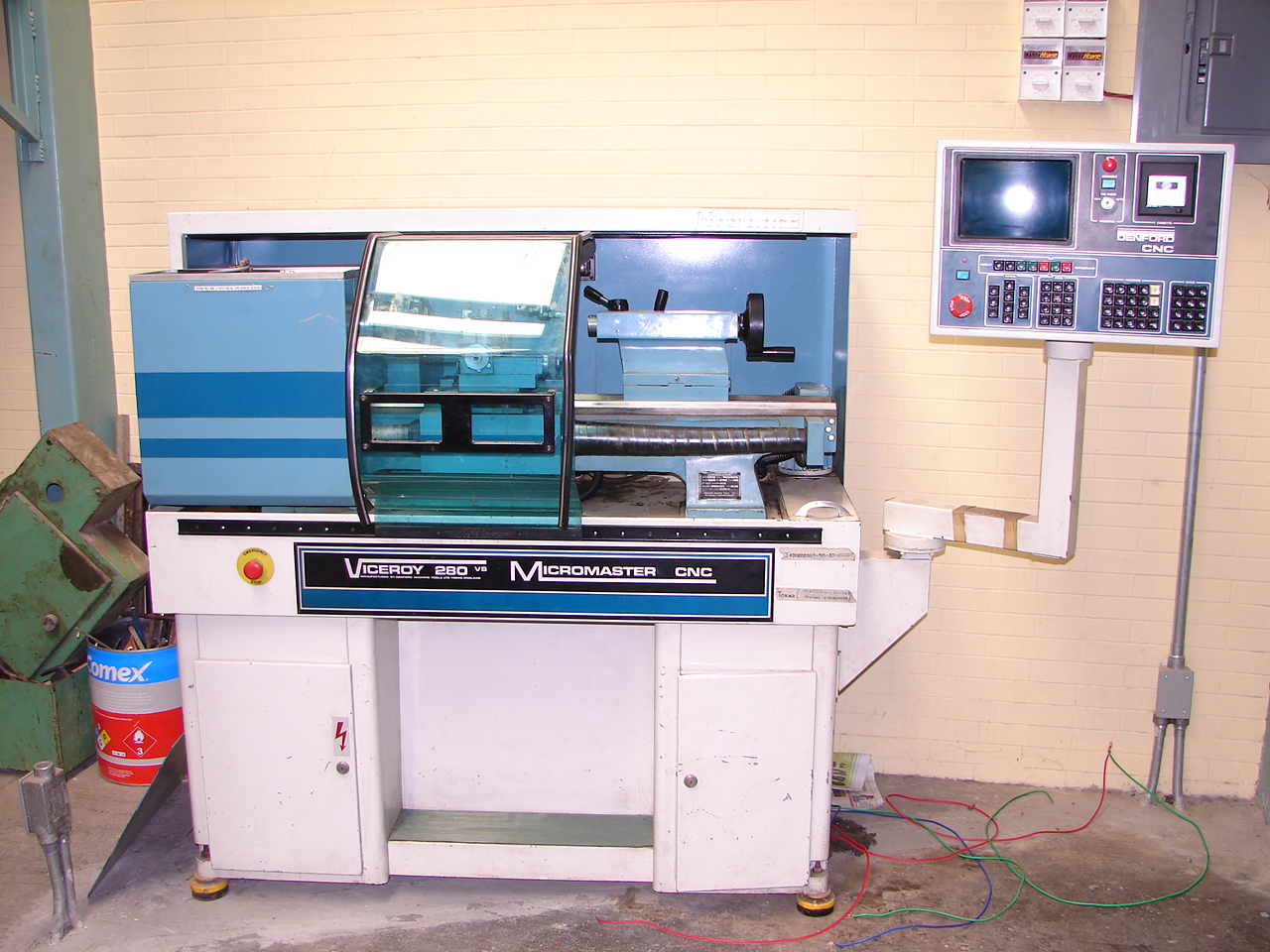

i´m a student in my last year of industrial engineering, and I need all the information available for this machine, manuals, diagrams, sketches, CNC, or any kind of information that may help me. I put some pictures, and thanks for the aswer to this post.
Machine Information
VICEROY 280 vs Micromaster CNC
Model: TDS/M/C Serie: 31371/C/N/C
Denford Machine Tools LTD.
this machine have a error : System faulty engine and transmission
i appreciation any help, thank
this is a machine, i need star
Viceroy 280 vs
Viceroy 280 vs
You mean the motor doesn't work? It looks like the wiring diags for an Easiturn would be very similar (no I don't have any) try a seach on the site.
If the Variable frequency drive is duff you can easily find another similar one to fit. If you're doing industrial engineering it'll be right up your street.
Is that the pictures of your machine? doesn't look like its ever been used.
