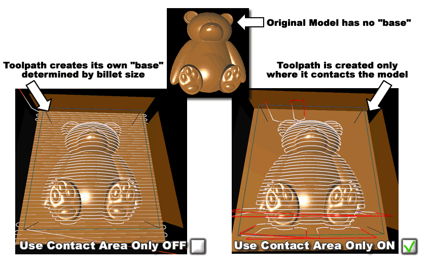

We have been asked to explain what Contact Area Only means in the machining plan options
The Contact area only option alters how the toolpath is created.
When on, only the model surfaces are used
When off, the square area of the billet is used as well as the model surface (in effect adding a clearance area to the model)
NB, If your 3D model is already created with a "base", then you will not see any difference in toolpaths with the option on or off
The following image hopefully shows the difference this option makes...
