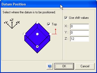

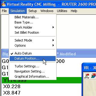

With the simulation Window active there is a Simulation window at the top of the screen.
Select the Datum position option and then select where you want to work from. :D
You can add an offset to allow the datum position to be in the center of the hole of an F1 car for instance. :idea:
dat pos.jpg (17.32 KiB) Viewed 6178 times
