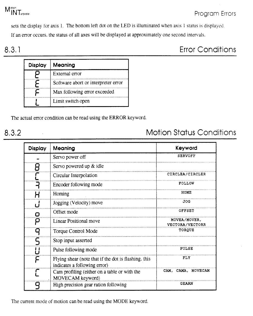

This is the chart for the older Baldor smartstep control boards...
there is no sign of a 7 :?
Does the machine function?
Does the number change when you hit E-Stop?
It's an "L".
The card is installed vertically in the control box, had to get the right orientation.
Checking the home switches and wiring.

In my notes "L" can mean "Denford Software Not Communicating" with the machine
Will check the switche first.
