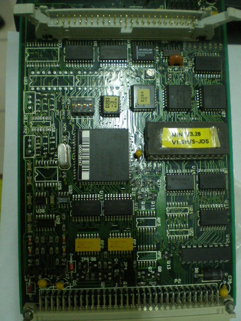

Can you attach a photo of the damaged card ?

Sorry to keep going on about it, but a picture of the card will help locate the correct software as well :)

These are some pics of the card and machine
These are some pictures of the card and machine. Thank you for your advice

picture of the card 1
picture of the card 2
picture of the card 3
