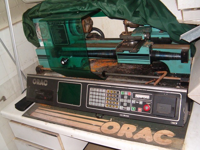

Can anyone identify this machine, not got my hands on it yet only the photo.

ORAC.
The electrics were produced by GSM.
By the way GSM are out of business now

Unless you see it fully working, I would guess that you are going to have to inveset a bit of time and money gettting it to run with modern PC software like Mach 3.
The tape drives cause lots of problems as you will see from other posts on here..
Ah! now there's a useful piece of info, I have not seen the machine yet and did not realise it was tape driven.
I had been told it's only a few years old, guess that's wrong then.
Wouldn't know where to start getting it to work with any PC yet but give me time....................

The Orac`s were produced around 1982 - 1986 I think.
