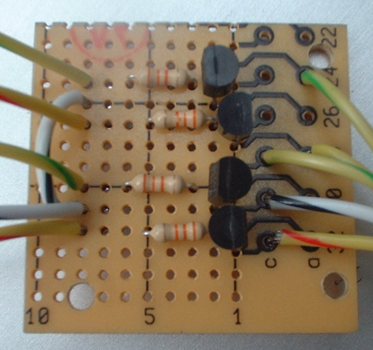

Sucess on a veroboard
What was the problem? Backlash enabled in Mach3. I swear that's how it came out of the box! :roll:
I was checking the veroboard again for the umpteenth time and I noticed that I'd stuffed in the wrong resistors :oops: (not very good at this am I?)
I changed one on the direction line to see if it made any difference - nope diddly squat. So at present I've left it.
Piccys attached to show it going together & I'll add a drawing of the veroboard (with the copper breaks :oops: ) so the electronically challenged can follow (and I'm not e.c. :roll: )

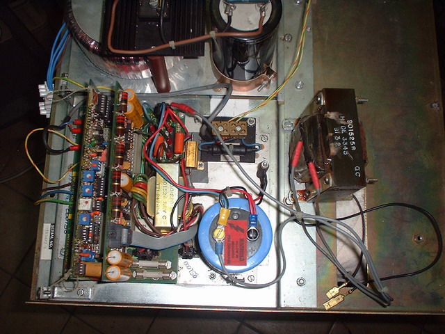

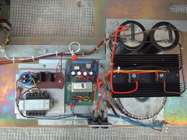

The odd bit, I think, is the power units.
On the left is the 24volt dc supply for the digiplan drives, which I don't think is original Orac (that's what I got in the box)
Centre is the power supply for the breakout board - 5v some breakout boards come with their own power supply built in so for some that might not be necessary.
Right hand side is the stepper motor power supply, rather over the top I think Mr. Denford. (no doubt you had a good deal for them :wink: ) rated at 2 x 7.5Amp & 45v ac driving 2 helpless little stepper motors rated at 2.1A

The more observant of you will note that the resistors are 33K rather than 3K3...my eyes 8-)

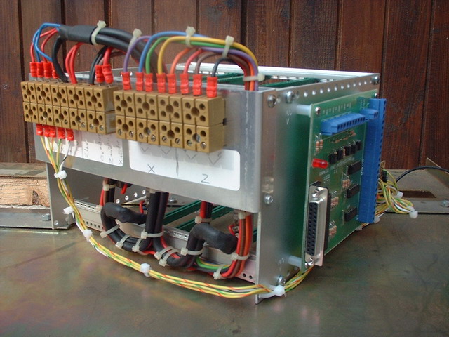

The saw off rack holding the digiplan drives with (most) things labelled

Side view of rack showing the cunningly mounted breakout board - a very old C1 board (cnc4pc.com)

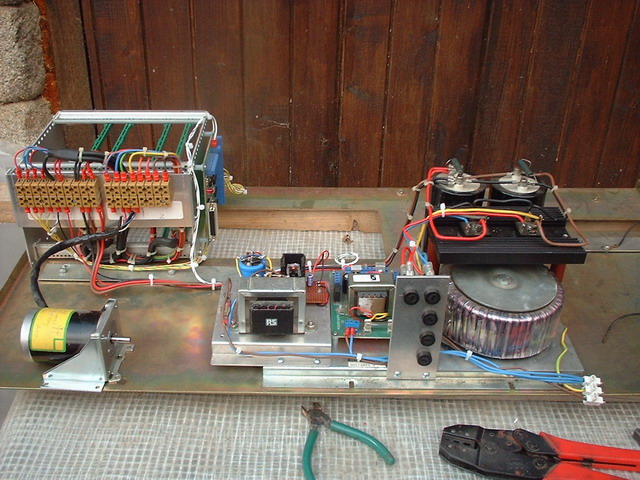

General layout so far OK there's not safety devices installed yet, well a few fuses maybe
Close view of the power centre

Right hand side is the stepper motor power supply, rather over the top I think Mr. Denford. (no doubt you had a good deal for them ) rated at 2 x 7.5Amp & 45v ac driving 2 helpless little stepper motors rated at 2.1A
Shouldn't that be 45V DC? High voltages are great for stepper motors, and the high current side is very useful when you want to upgrade ;)

Won't putting in the wrong resistors seriously limit the current available at the transistor and may lead to switching problems?
Nah, I was talking about the power supply, & rectified as you probably know it squirts out (technical term that :) ) 63volts dc measures about 60 on my toy multimeterm which incidentally I smoked today checking out the original VFD :roll: but the lack of multimeter shouldn't lessen my electronic expertise in the least :mrgreen:
But the OTT transformer, as you say, is brilliant for upgrades, the ones in the easimill & easiturn also had 18v taps as well - great for relays
Well yes I would have thought so, but my inability to decipher simple transistor specifications (and resistor colour codes) means that they work in my ignorance :lol:
