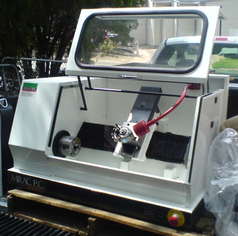

Need help w/ setting up a newly acquired Mirac PC
I recently acquired a 1994 Mirac PC through an online transaction with the original intent of scrapping the motion control hardware and refitting it w/ some geckodrives and updating to mach3 control software & XP, etc...
However, much to my surprise the machine is in near perfect condition and I am still a little stunned at how lucky I am to happen across this little beauty and so there's no way I can even consider cannibalizing this thing - given the condition it is in. It really deserves a proper turn. ;)
Anyway, I know very little about these machines but have spent the past day researching on this bb and have learned a great deal already. The machine did not come with the PC, software, manuals or rs232 cable, etc... I have just the machine, control box and main interface cable between the two.
I have already downloaded the software based on the information I've found here and am going to search for an old 486/DOS laptop I have buried somewhere deep in my garage and try to install the Mirac software on it. However, I will most likely try loading up DosBox or VmWare on my newer PC that's running XP and try to install the software under DOS emulation.

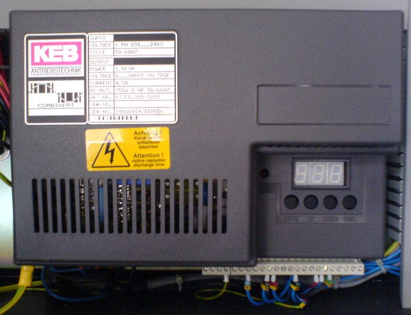

Spindle Controller
Spindle Controller

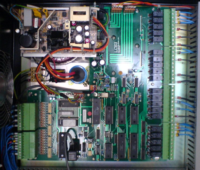

LCB3 Controller
LCB3 Controller

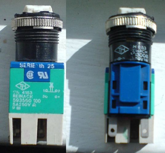

I went over the machine pretty closely last night and the only damaged part I found was the front panel "axis override switch". Aside from that there is a little rust on the spindle and motor pulleys that should be removed. But, everything else looks to be in good mechanical order.

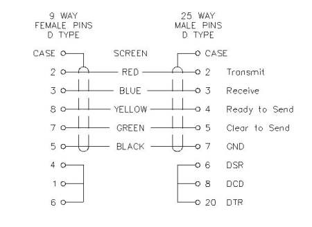

So, I have hit a wall with the rs232 cable configuration. I have tried a combination of 9pin and 25pin cable connections between the pc and controller board with no success. I have tried altering the mirac.go file along the way but am consistently getting the following error upon launching the software:
Error <128> Software aborted
This error comes up almost immediately (directly under the initial line, "Denford Mirac CNC Programming v2.25 11 June 1997"). I am assuming that it is aborting after not locating the machine through the serial port.
I'm pretty certain that it's my cable configuration and possibly the .go file since the mirac manual mentions that the supplied 9>25pin Denford machine cable has some custom crossover links to it and I have been using either a straight-thru (pin-to-pin) cable or a common "null-modem" (full handshake) cable adapter.
My guess is that I will need to create a cable to emulate the denford one but I'm clueless as to how it should be configured. I have found several different bits of information on the forums here but nothing definite. In some posts I have read that I should only need a straight pin-to-pin cable but then the manual mentions the special cross-over wiring and not all the info here pertains specifically to the mirac pc so I'm really mixed up at this point. :|
FYI, I'm running DOS on an older laptop and it has one serial port however I am not using the denford keyboard.
BTW, can anyone tell me what the "18.2 x" line in the .go file represents? And what the heck is the macmirac.go file and do I need to be concerned with editing it as well as the regular mirac.go file?
I would greatly appreciate any help on this! Thanks!

Does it matter that the wiring inside the control box doesn't match the cable diagram? I noticed that the color coding appears to be different than the diagram when compared to the wiring from inside the control box.
The wires all appear to be in the general area (pins 2,3,4,5,7) but the color coding is mismatched compared to the diagram. For instance, the diagram calls for the red wire to connect to pin 2 for transmit and the blue to pin 3 for receive, however (looking at the image below) the controller seems to be wired the opposite of this. And likewise the green and yellow wires appear to be swapped as well. Do you think this matters?
The drawing is for the external lead. PC to electrical box.
As long as you wire the connections as shown it will be correct.

I have a question regarding the grounding of the shielded portion of the cable. According to the diag the shield connects to the "case" rather than pin 1 so where do you think would be the ideal place to connect these (drain wires?)? It looks like it's calling for both ends to be grounded to the "case".
Here's another small item that needs addressing... the axis override limit switch. By chance does anyone know of a replacement for this item, I can't seem to track one down. :|
If you have metallic shells, then use their cable clamps to get a connection around the cable shield, to the metalwork of the PC and control box.
If you are just "lashing" something up, then try get the shields connected to the metalwork at both ends - maybe using the D-type screws to tighten onto.
As for the switch, I'm not sure if this is exactly the same, but will at least get you in the right place:
RS item 503008
https://uk.rs-online.com/web/2508770779.html

Well, I built a new machine cable based on the IBM compatible wiring diagram mentioned above (see image below) but am still getting the 128 error. Both ends of the cable are grounded and I wired everything up according to the diagram so I'm stumped.
I'm not sure why the diagram calls for the jumped pins (6-8-20) on the 25-pin end since none of the wires on the controller side appear to be connected to any of the pins called out in the diagram. :?
Does anyone know if there is a pause during the initial launch of the mirac software where it searches for the machine? The reason I ask is that it is launching directly into the <128> error line without any hesitation whatsoever and it makes me think that something else is going on besides the cable.
I have a feeling that it has something to do with the MIRAC.GO file. I revised it according to Mr. Magoo's earlier post since I didn't receive the tutor keyboard with the unit and am using the built-in keyboard from the laptop in place of it. Would the fact that I'm using a laptop make a difference by chance or would it have the same configuration as a desktop pc using an external keyboard?
Any ideas on where I could go from here to trouble shoot this? I would greatly appreciate any advice. ;)
