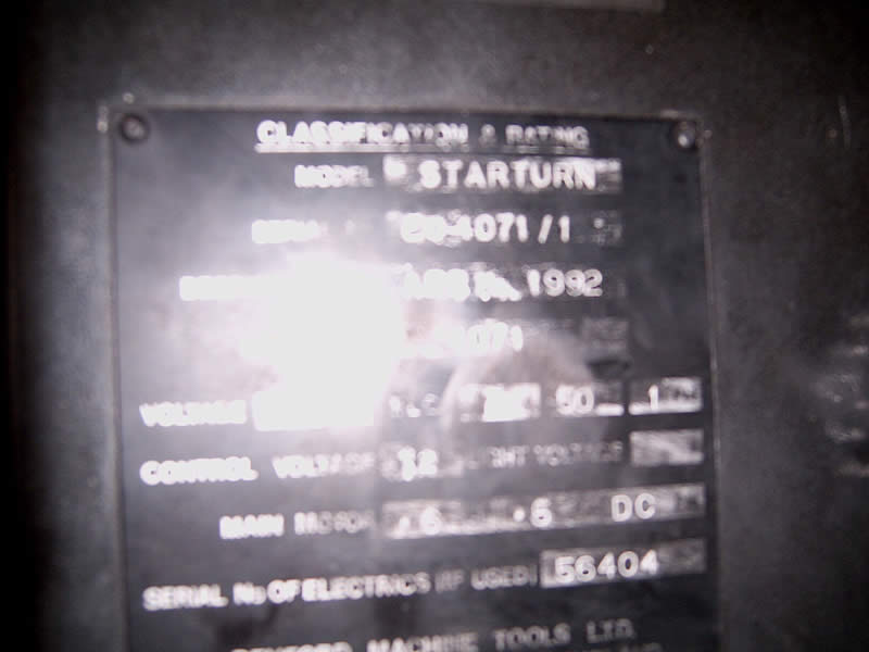

i add some pictures of my machine
STARTURN
STARTURN
