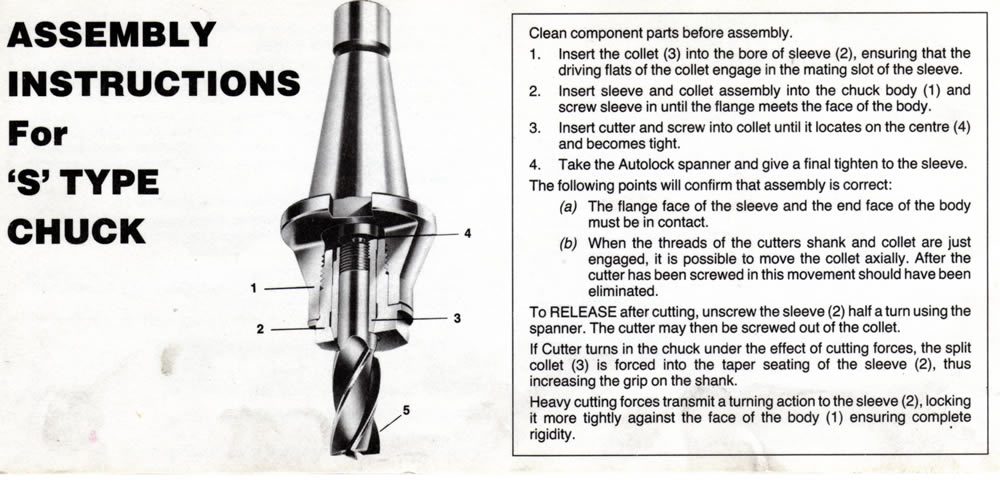

I have even managed to find it :D :D
Here you go, perhaps Admin could put it in the downloads, for others to use? As I know a lot of people struggle with not knowing how to correctly operate the Autolock chuck.
Sorry the Pics are so big :!: , I have limited photo editiing on my work laptop :(
Well you live & learn! I always leave a small gap and then winch it up with my mole grips :lol:
If somebody has a clarkson spanner.....
