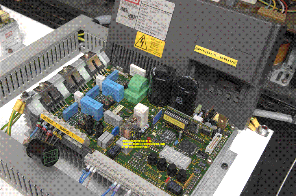

This shows the spindle drive, the led is powered but the 3 '8' figure displays is not lit, please ignore the filename :)
Spindle Drive Powered But No LED's lit.GIF (192.78 KiB) Viewed 29795 times

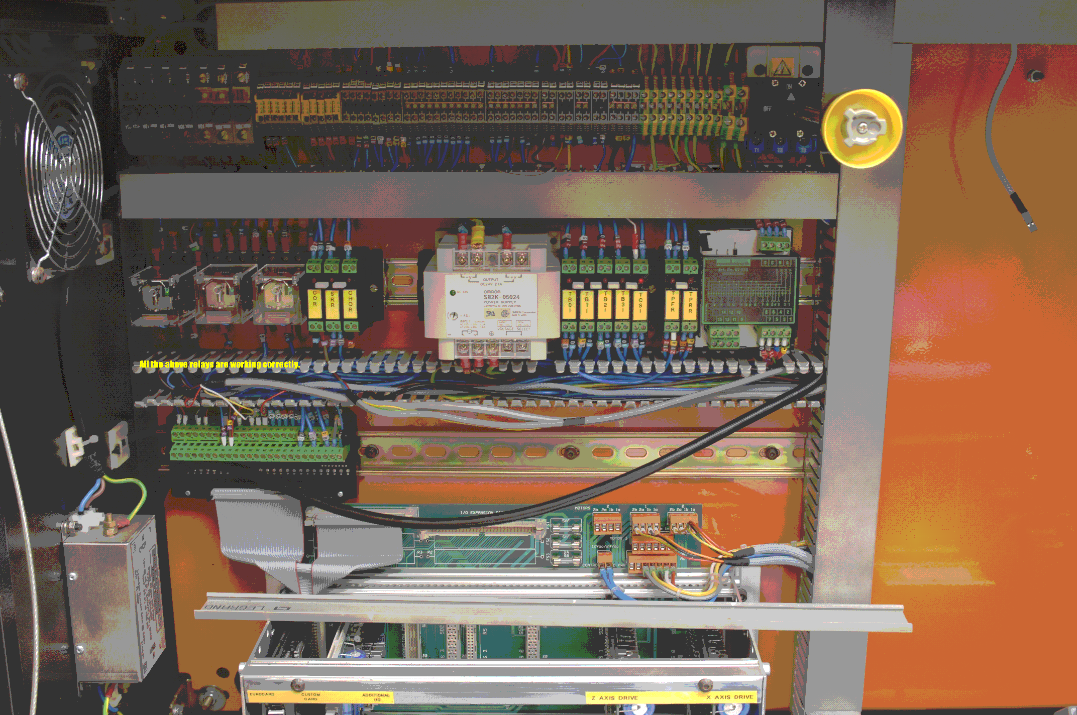

photo of the main layout
main panel.GIF (529.37 KiB) Viewed 29795 times

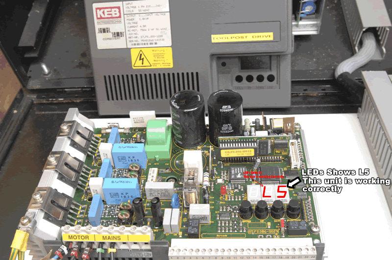

Photo of the tool post drive. This is working correctly
toolpost Drive working correctly.GIF (160.2 KiB) Viewed 29795 times
hello?? any1 here? :)
Hi Chadha...
All looks Ok on the photo's so It's looking like a knackered spindle drive. Some suggestions...
- Confirm the 1-1/4" fuse mounted top-left side of the spindle drive PCB is OK (not sure if you've checked this)
You could try swapping the spindle drive and Toolpost drive over to prove it's a faulty spindle drive. It's OK to do this as long as the motors don't run.
- Swap the drives over and connect up the mains input and motor cables
- don't plug in the right hand long 23 way connector to the drive - this will mean the drive can not enable itself and so can not try to run the motors
- turn the machine on
- if the (now) toolpost drive is dead & the (now) spindle drive lights up then its a faulty drive - you know what I mean!
