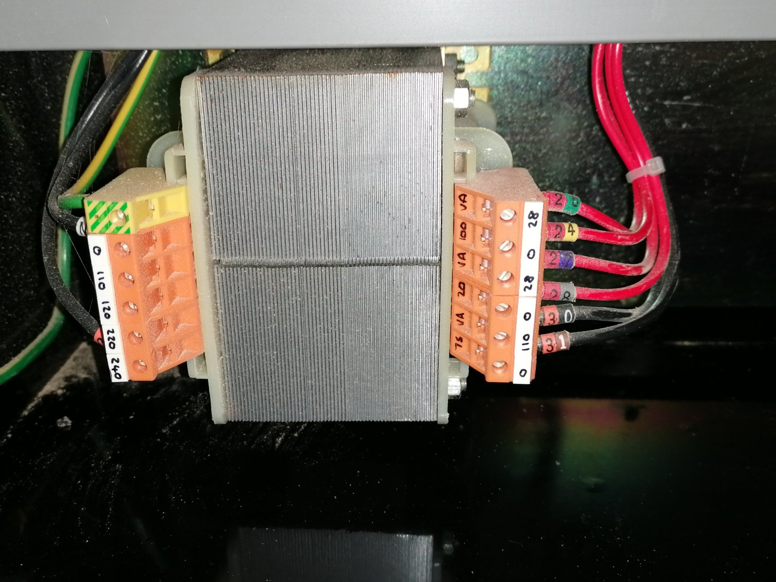

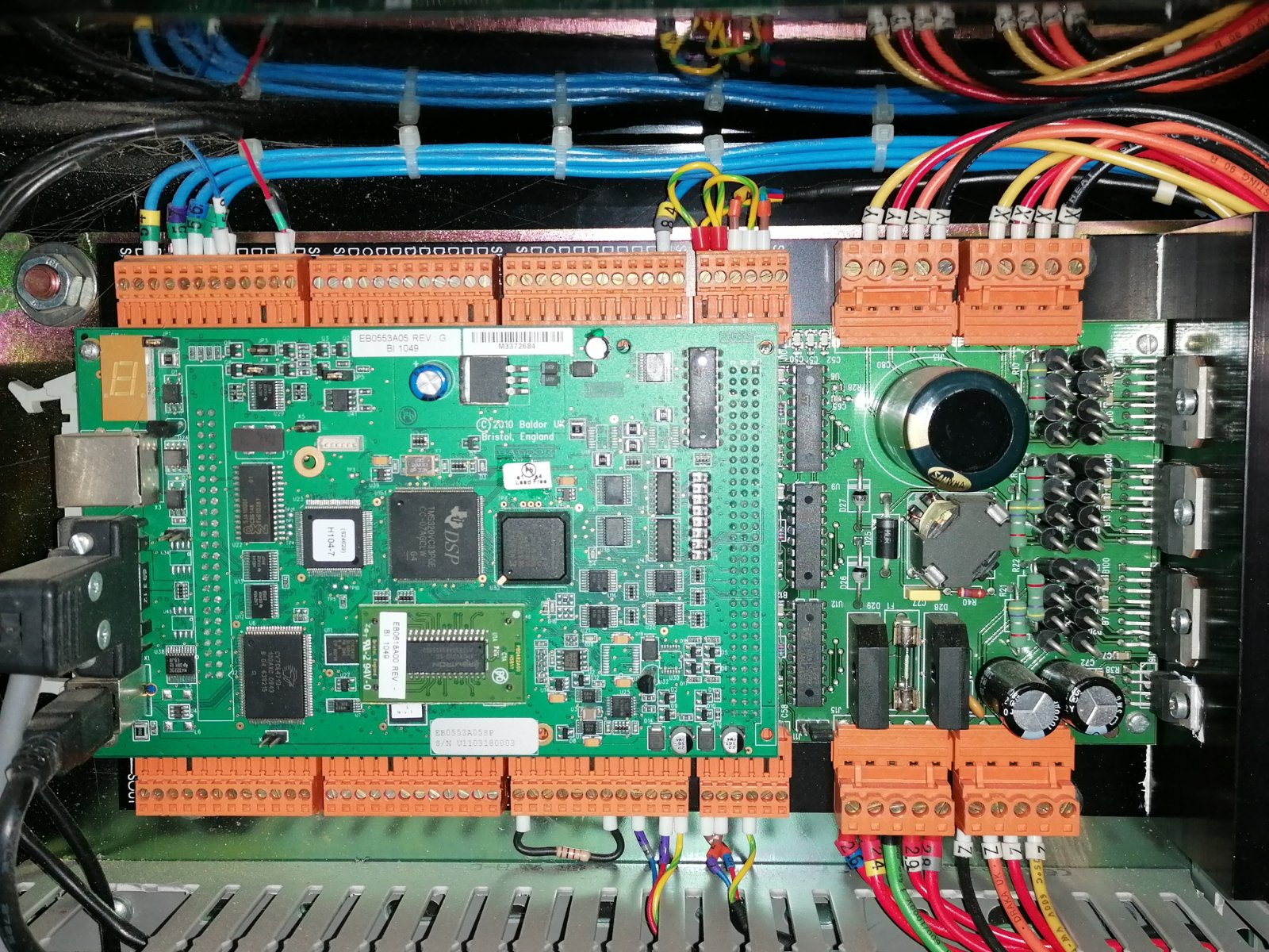

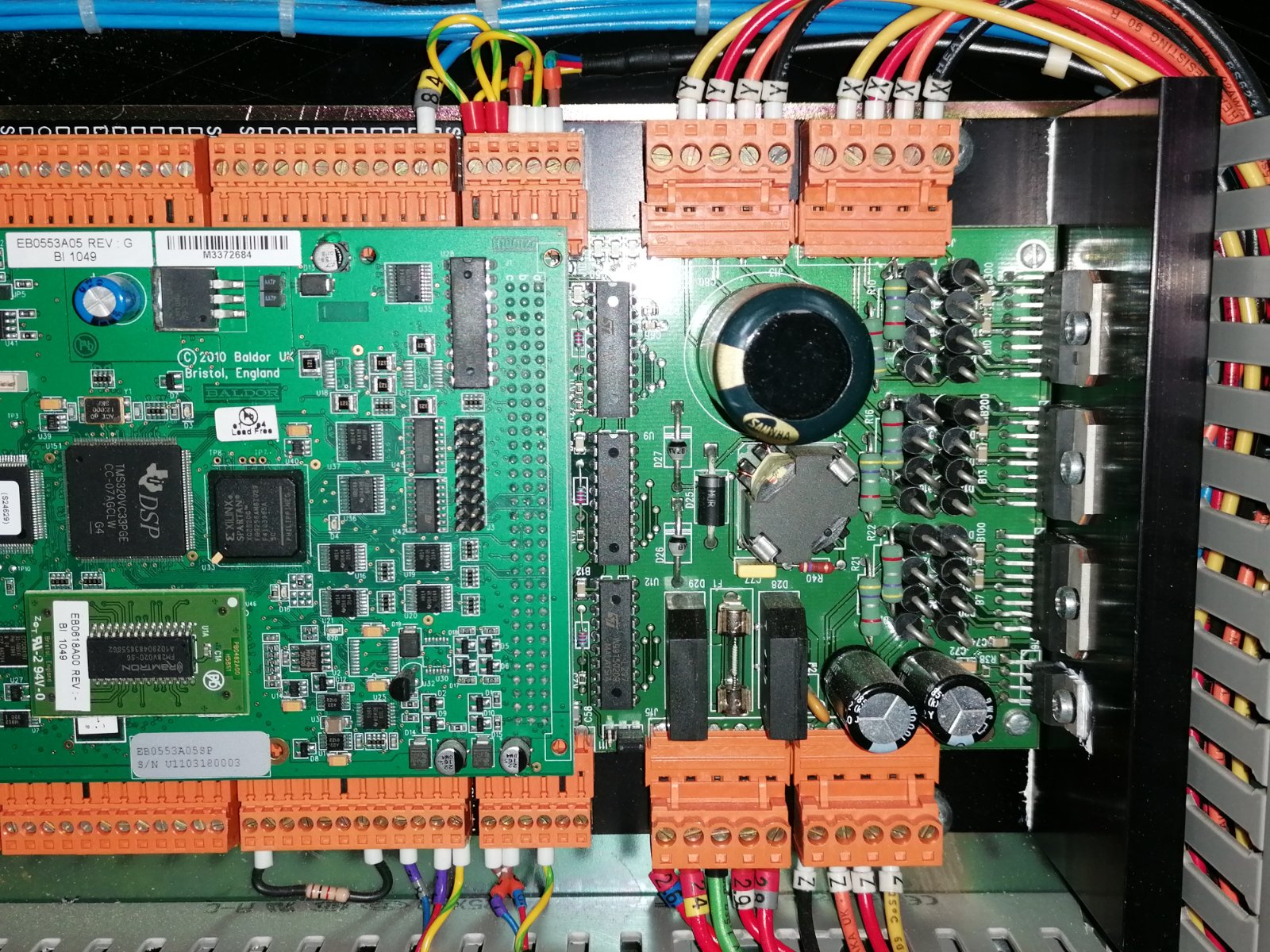

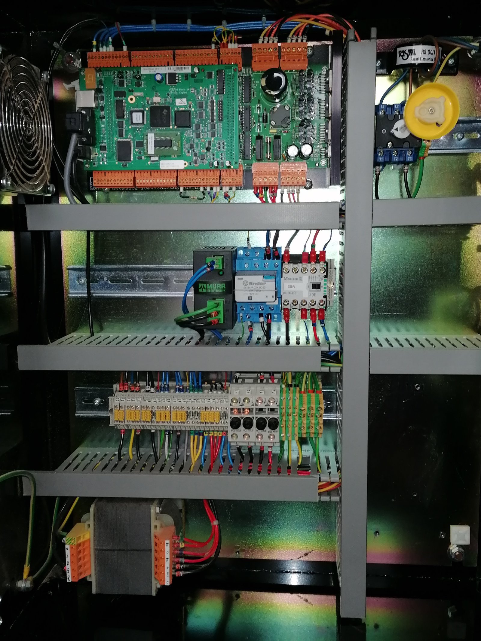

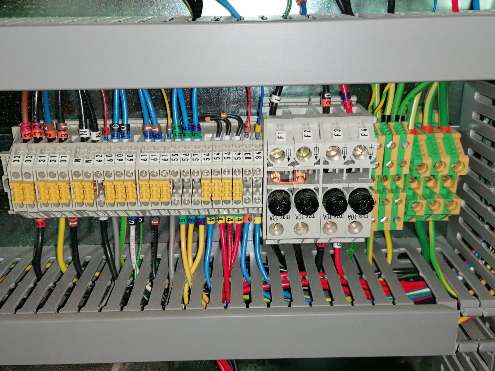

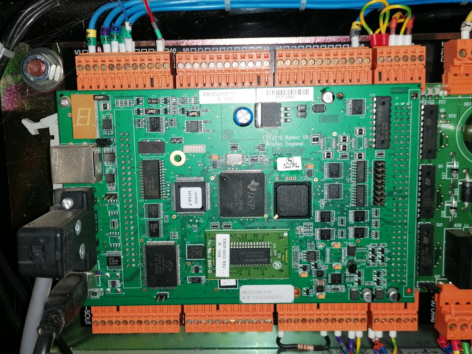

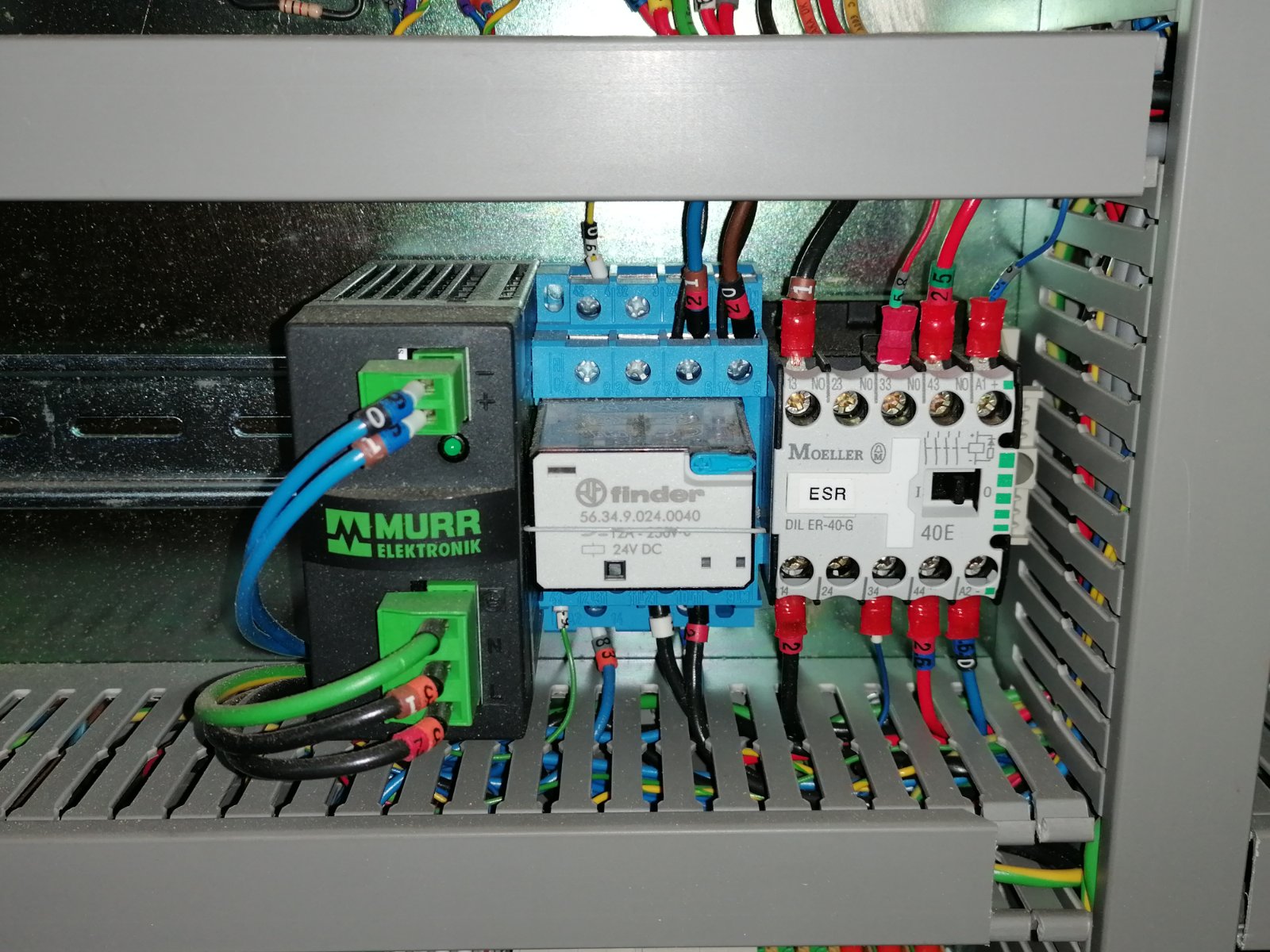

Here are pictures of the inside of my machine and the wiring. I have all the schematics, but they are from when the machine was manufactured and are dated 2000\2001, on the old 'DenStep' controller. Since then it has been upgraded to 'NextStep' so not sure how relevant, useful these diagrams are now. If anyone has any schematics or electrical diagrams for the NextStep card, and any info on my setup would be great.

I have an electrician coming tomorrow. It looks like Version 5 if I'm correct? It's very difficult to tell as it was upgraded from it's original control card.

The board connection are similar to v5, but is not v5.
You don’t have a timer or separated driver for the motors.

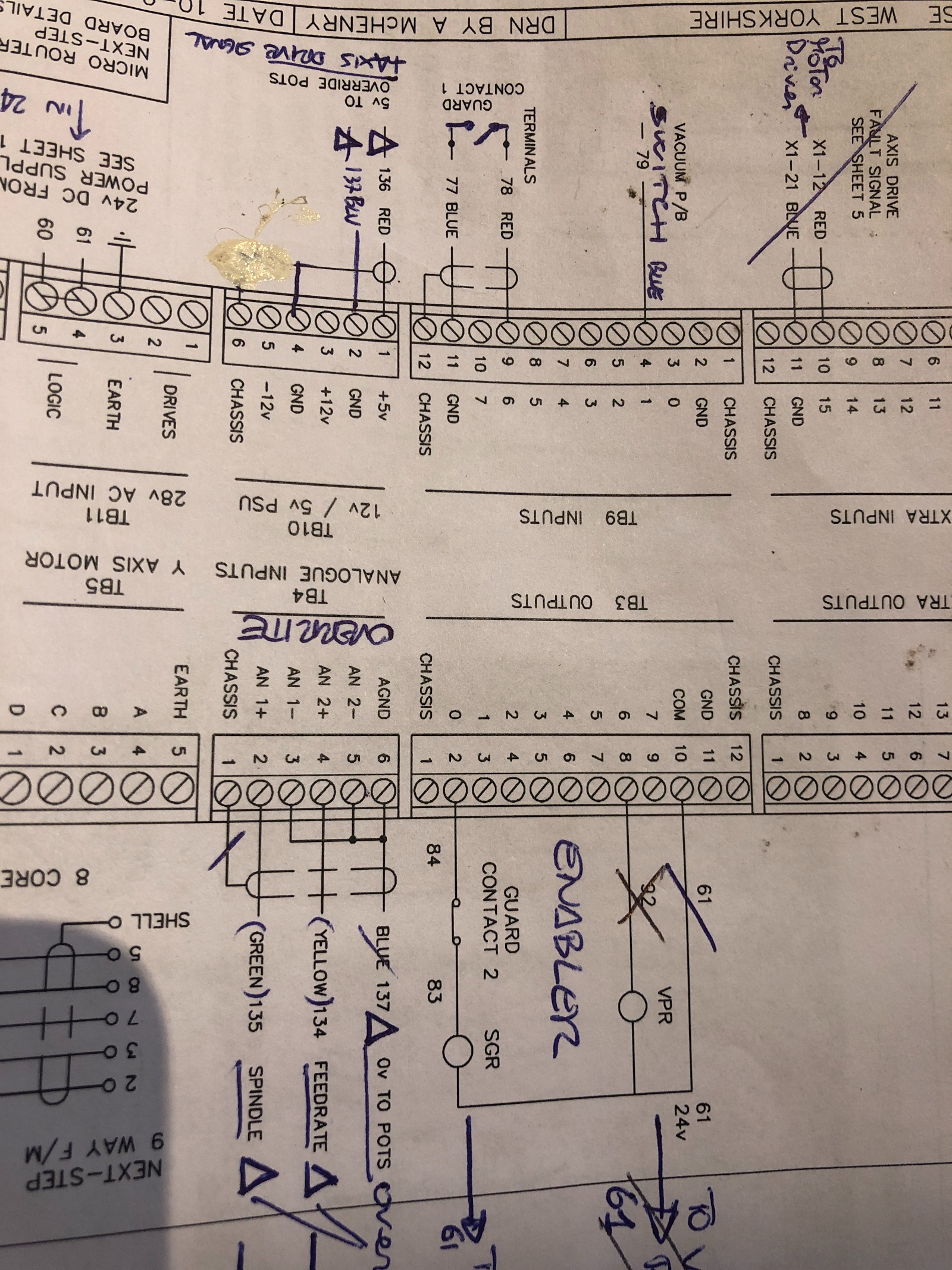

On your board, in TB9 (bottom, third group from left), you have 3 cables, should be numbered 78 77 and the third is ground.
That’s guard contact 1.
Have a look.
I removed it from my Bob.
The other guard contact pin is on the top of the break out board, group TB3, visible in the pic you posted and numbered 84 , this one if you open the door the spindle will stop spinning since is the relay enabler.
Pin 84 goes to the switch and then into cable83 that enter the blue relay in your cabinet. If you want to bypass the contact guard switch (to enable the spindle even if door is open), you can disconnect pin 84 from the Bob and connect a cable that enter directly in the blue relay (remove cable 83). It should be -24v.
Please note these are my advise but you do this at your risk.
Have a look at MY bodged diagram in pic and look at pin 77, 78, 83 and 84
