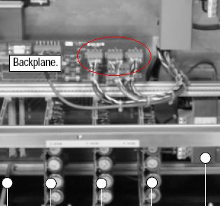

When i try homing the X axis baldor card writes "H"
When i try homing the Y axis baldor card writes "8"
When i try homing the Z axis baldor card writes "8"
I checked DC on terminals shown on the picture: is not present.
I checked all fuses in the axis card and in backplane: are ok.

YESSSSSS!!!! I did it! :fireworks: :lolol:
The machine works!
The fault has been an abnormal contact of a fuse on the backplane!
Thank you all for your advice and thanks to Denford for the support.
