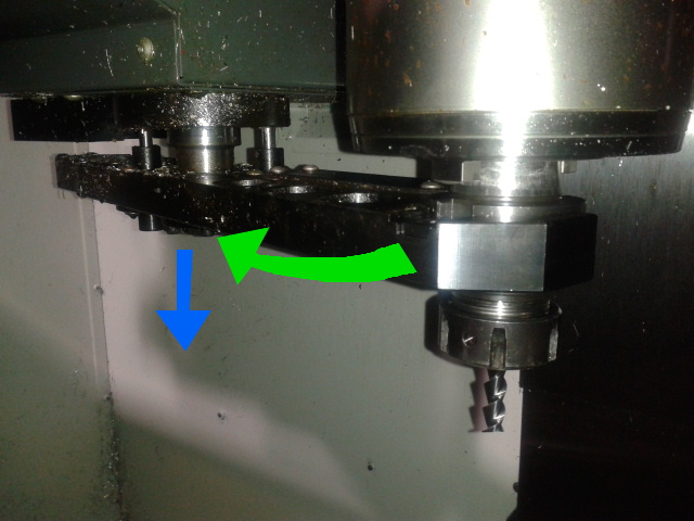

I realise I'm a little late to the table and I haven't read the whole way through this thread, but i thought I'd throw a little compromise idea into the ring for those who might want a (slightly) simpler solution.
The last Haas I bought had a 24-tool carousel mounted vertically, between this and the spindle was a simple double ended (hooked) arm with a pivot in the middle. The carousel rotates/indexes to the desired tool, the arm engages with the tool in the the spindle with one end while simultaneously engaging the chosen tool in the carousel the with the other end. Arm drops down (removing both tools) spins 180 degrees and lifts up again (locating tools into the spindle and carousel). When finished, the arm rotates to a parked position perpendicular to the spindle.
It may sound complicated but is actually very simple and effective. The idea lends itself to a few options;
a) Simply have the double ended arm on its own, after each tool change manually load another tool into the 'open' end, ready for the tool to change when the time comes.
b) Have the arm and a six pocket carousel, rotate the carousel manually after each tool change, ready for the next.
c) Have the arm and a powered carousel BUT the carousel only rotates/indexes and doesn't move toward or away from the machine, the rotating arm makes that part redundant.
The final option is basically the same as the Haas and may or may not be simpler than the carousel indexing and then moving into position of the spindle :?

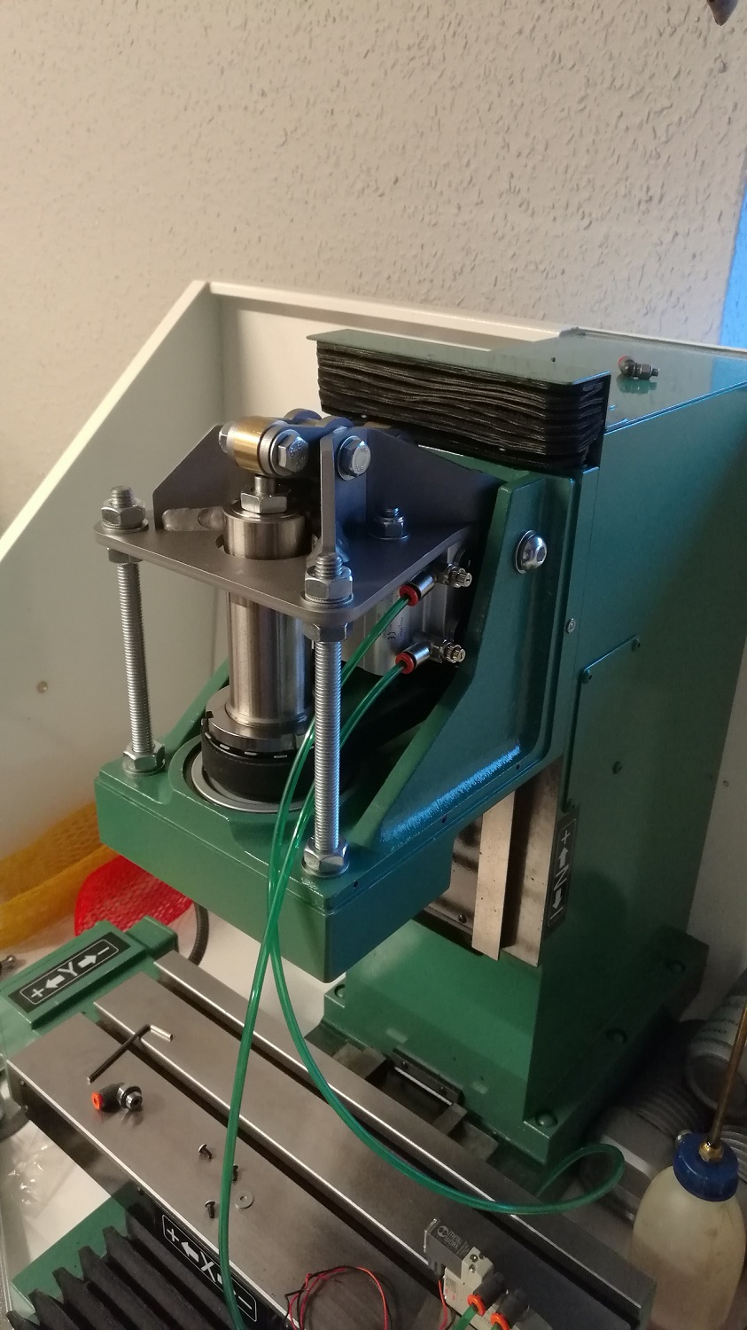

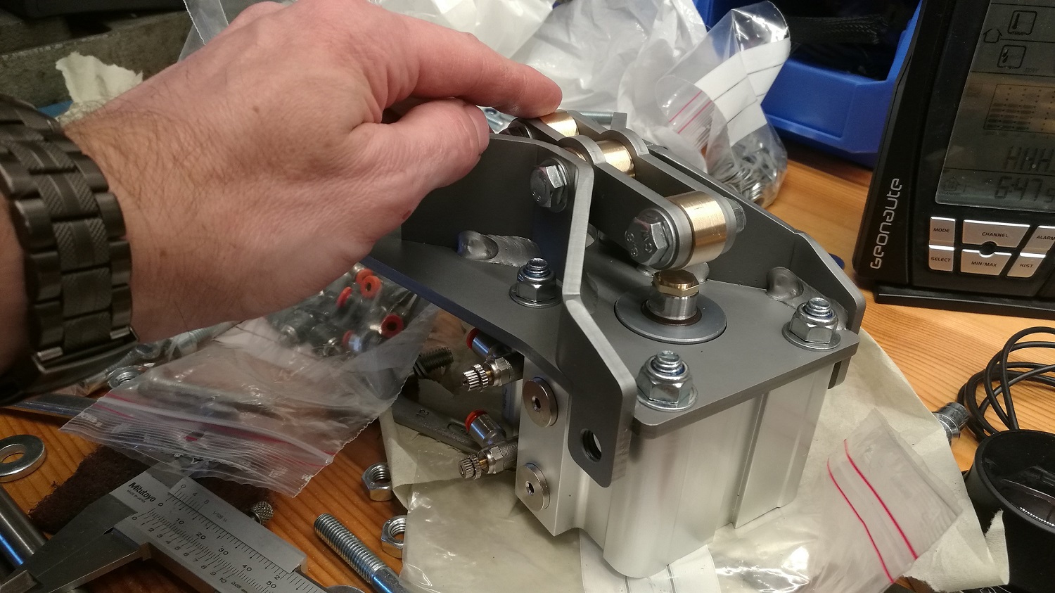

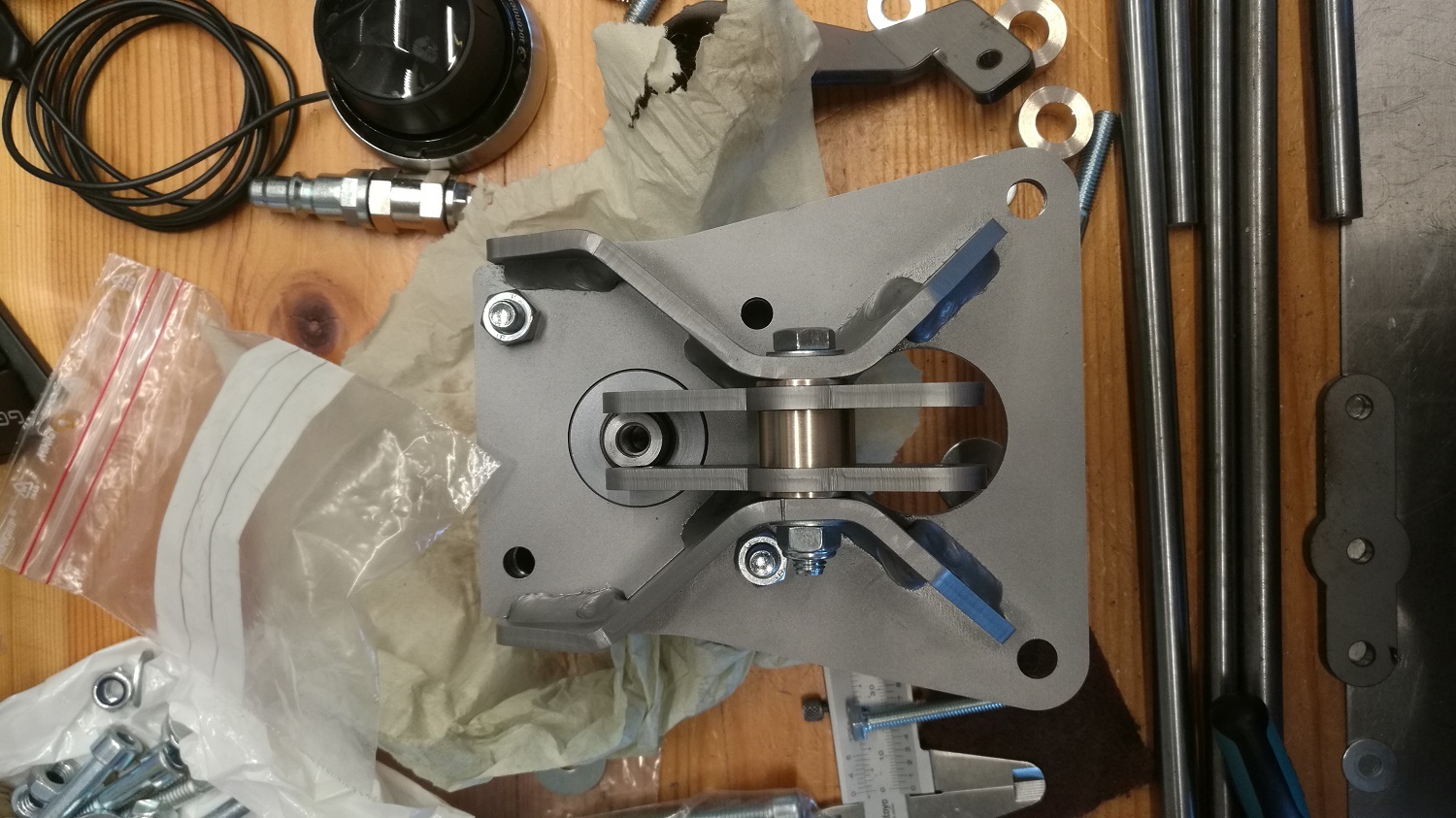

Re: novamill atc retrofit

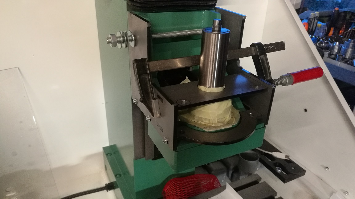

Hi all,
I have been busy with many other things the last while, but finally got som time to Work on my Novamill.
I never liked to have the drawbar design on the side, so I designed a new one that is able to have the original top on if you just make a cutout in the original spindle cover and make a small cover - I will make a new one soon.
Here is a short video https://www.youtube.com/watch?v=pf7msmJDxZ8
Some Pictures of my drawbar and drilling template...
Hope you like it.
Regards Morten

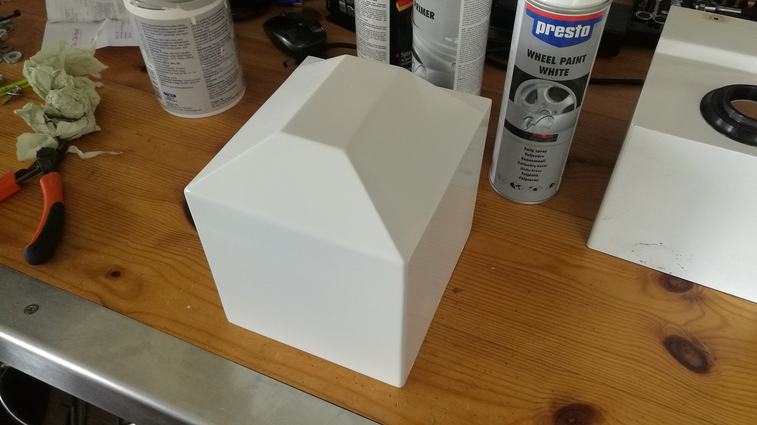

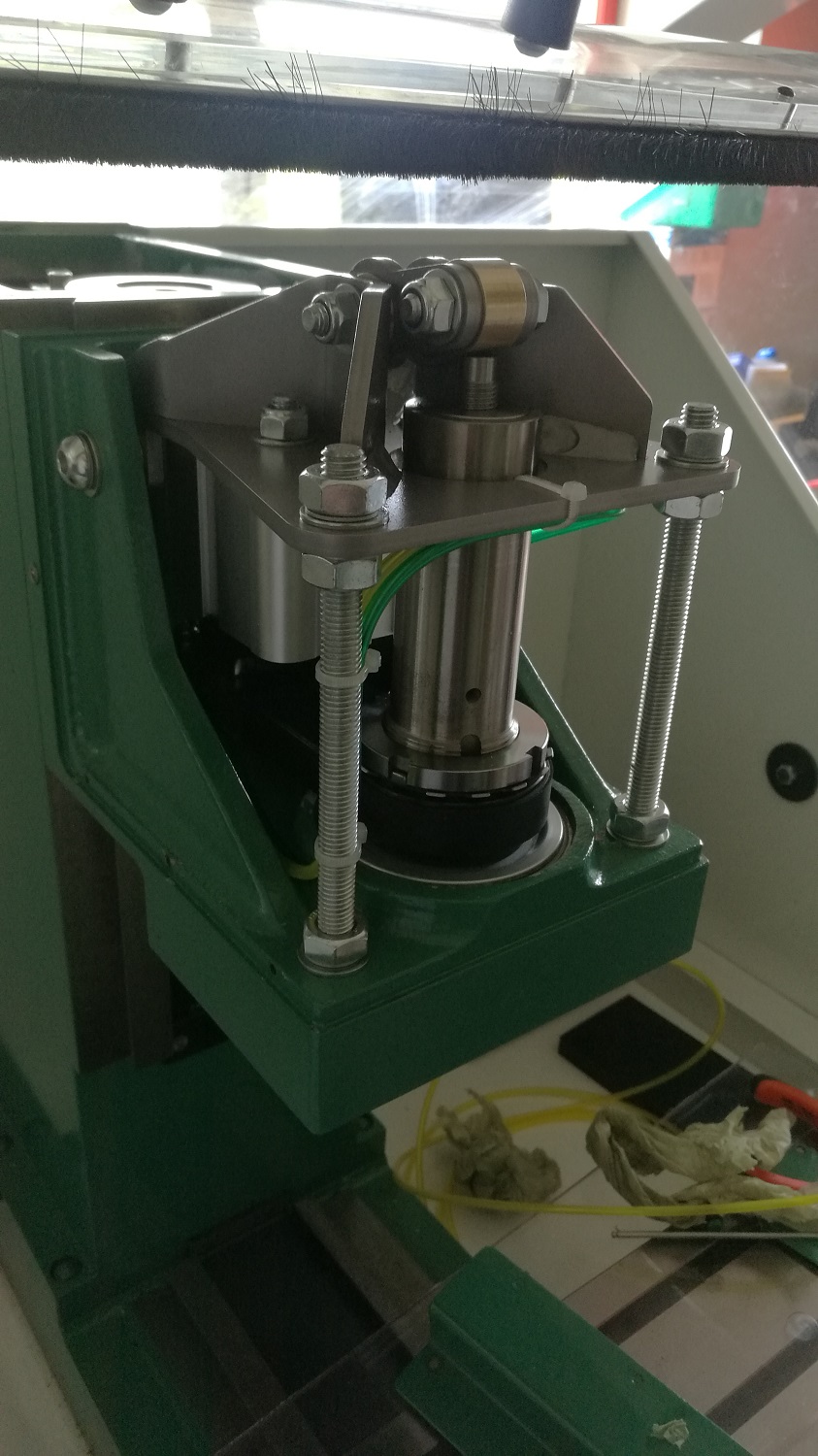

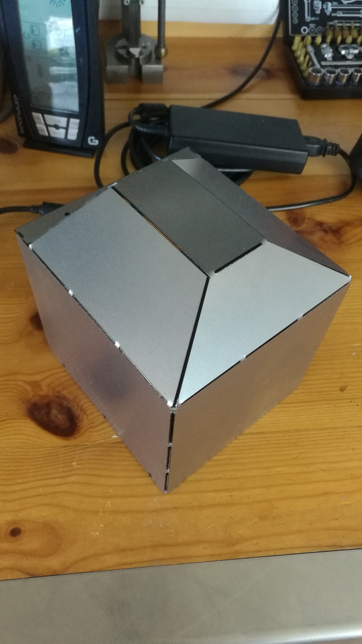

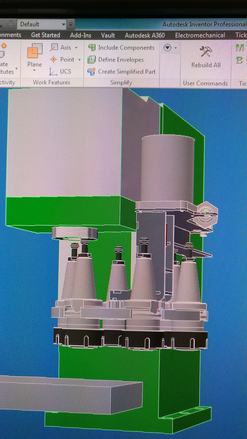

Hi all,
Just got finished with the head:-)
Here are a few more Pictures of it + a Picture of my carrosel design, but I will properly only start working on it later this year...
/Morten
