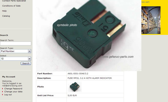

Is the fuse one of the green plastic ones with a white flag in the window to show the status of it?
I think the fuses are labeled on the fanuc unit.
If its labled 24VE then its the external supply to the 24V I/O
If you replace the fuse and it works great but if it blows again you need to find out what is causing it. The 24VE supplys all the home switches, guard switches etc.

Hi Steve
It is one of 2 fuses for the +24Volts, the other one is a 5.0Amp one, the 3.2Amp one is F13 and the 5.0Amp one is F14, which one covers which side of the 24V systems I don`t know, but you are probably correct.
See image from GE Fanuc site, reckon this is the one!!!
Alan, I agree strongly with Steve, if the fuse does blow again then you need to do some serious checking of all the things that are supplied from the 24V.
Rob
5 Euros for a fuse !!! I see Fanuc still know how to charge for stuff :shock:
I'd be sorely tempted to fix the existing one with fuse wire and solder...

Re: Denford cyclone info
Yes, they do still know how to charge big time!!!
Having said that paying €5.00 Euro for a correct fuse against the chance of "breaking" a £2800 pounds power supply unit is not the best plan to my mind!! Even getting one repaired would be several hundred pounds minimum!! :mrgreen:
