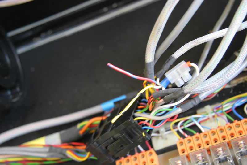

I have found evidence of repair/modification hidden in the bundled wiring. Behind the front panel in the vacinity of the manual speed controls ther was a 150mm length of yellow shrink sleeve. On removal I find four spade sockets. If you follow these wires to the other end of their harness ther is another piece of heat shrink concealing the other end of two of the wires which have been chopped. There is also a small chock blcck making alternative connections. See attached images.
I guess these mods were done to isolate the manual spindle controls as it is programable; safer where school students are involved

From what I rememeber, if the machine was ordered with the "Programmable Spindle" option then the push buttons/rotary knob on the fron didn't work - so these makes sense not working, but ESTOP would never have been disabled at the factory - "health and safety" and all that...
It's possible the mod's inside the machine were part of the 'programmable spindle' factory upgrade.
Don't think the label will be a Denford one - more likely to be from the school or local sparky.
