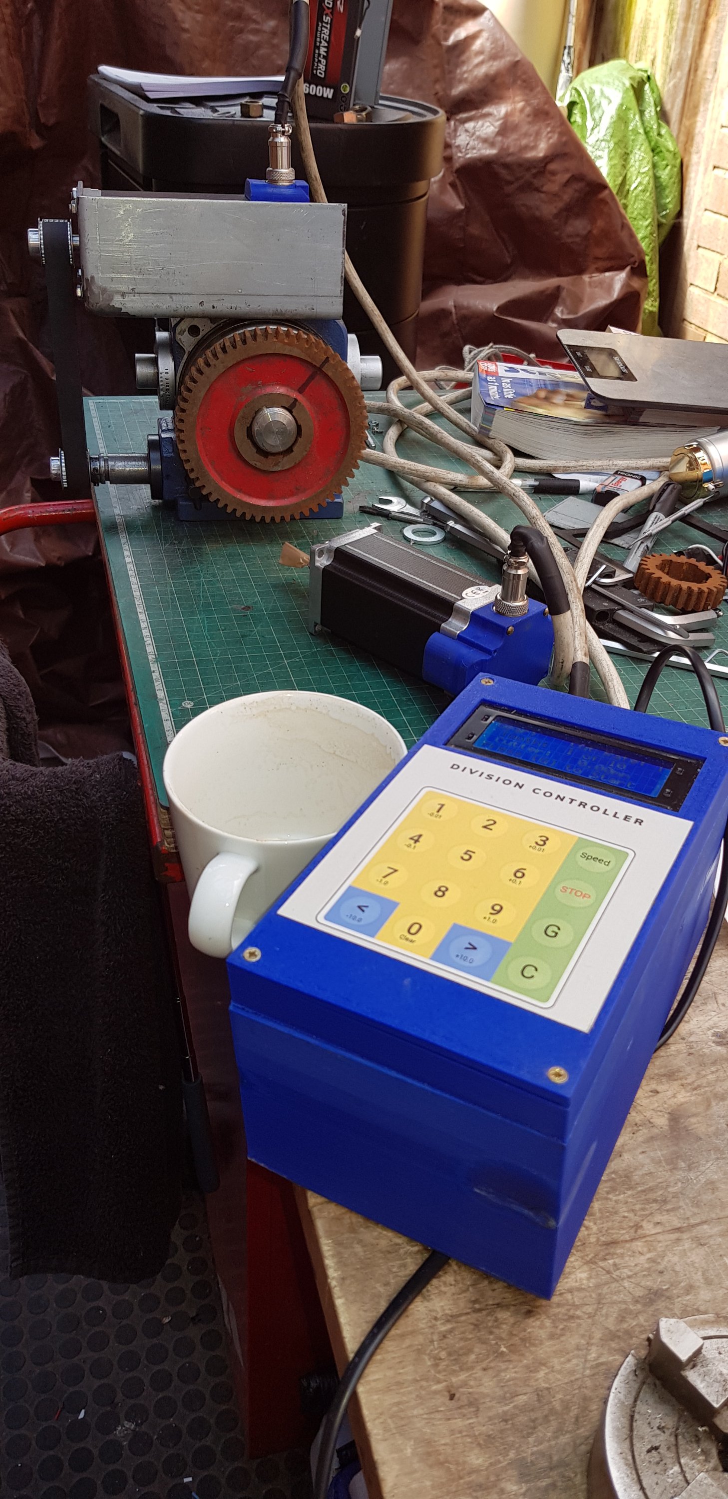

Working on my "Steve Ward" division controller which will allow me to also cut gears and splines with an indexing table
found a few bugs in it and he modified it to work , its now v3.2 and works a treat It has a linear control which works on my y axis for cutting and retracting , with the small indexing table to move to the next tooth to cut, it is all synced and works well . I am using 2x 542 drivers with nema 23 motors, and a small 24v psu which I managed to fit into a keypad box . It is also programable and comes with the indexing and gear cutting built in. He sells a kit either ready built or you can build it yourself . here is a link
https://www.worldofward.com/rotarycontroller/
here is a pic of me testing it with the brown taped spindle emulating the y table direction of advance to cut and retration with the indexer moving to the next tooth to be cut. the blue box contains the 2x 542 drivers, psu 24v, and the Steve Ward control unit with screen and keypad.
Steve answers emails same or nexday and is very helpful.
