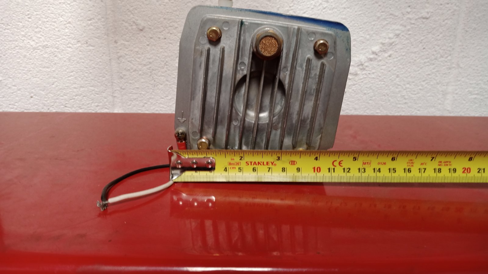

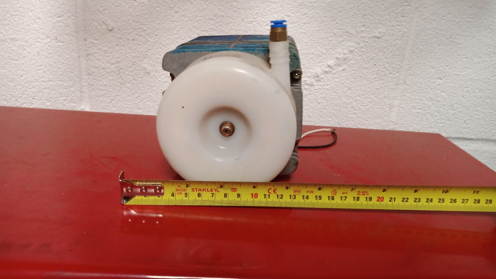

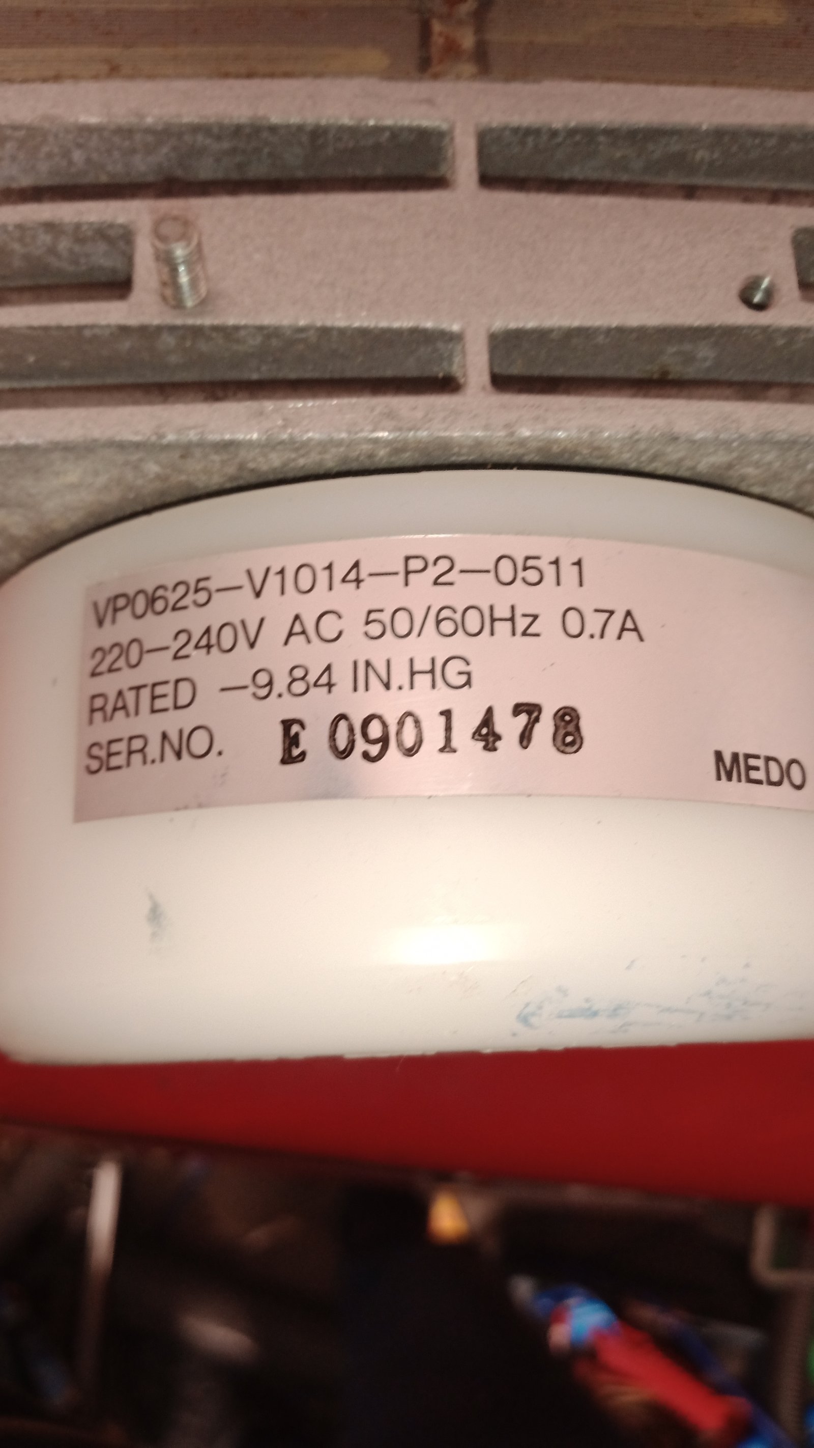

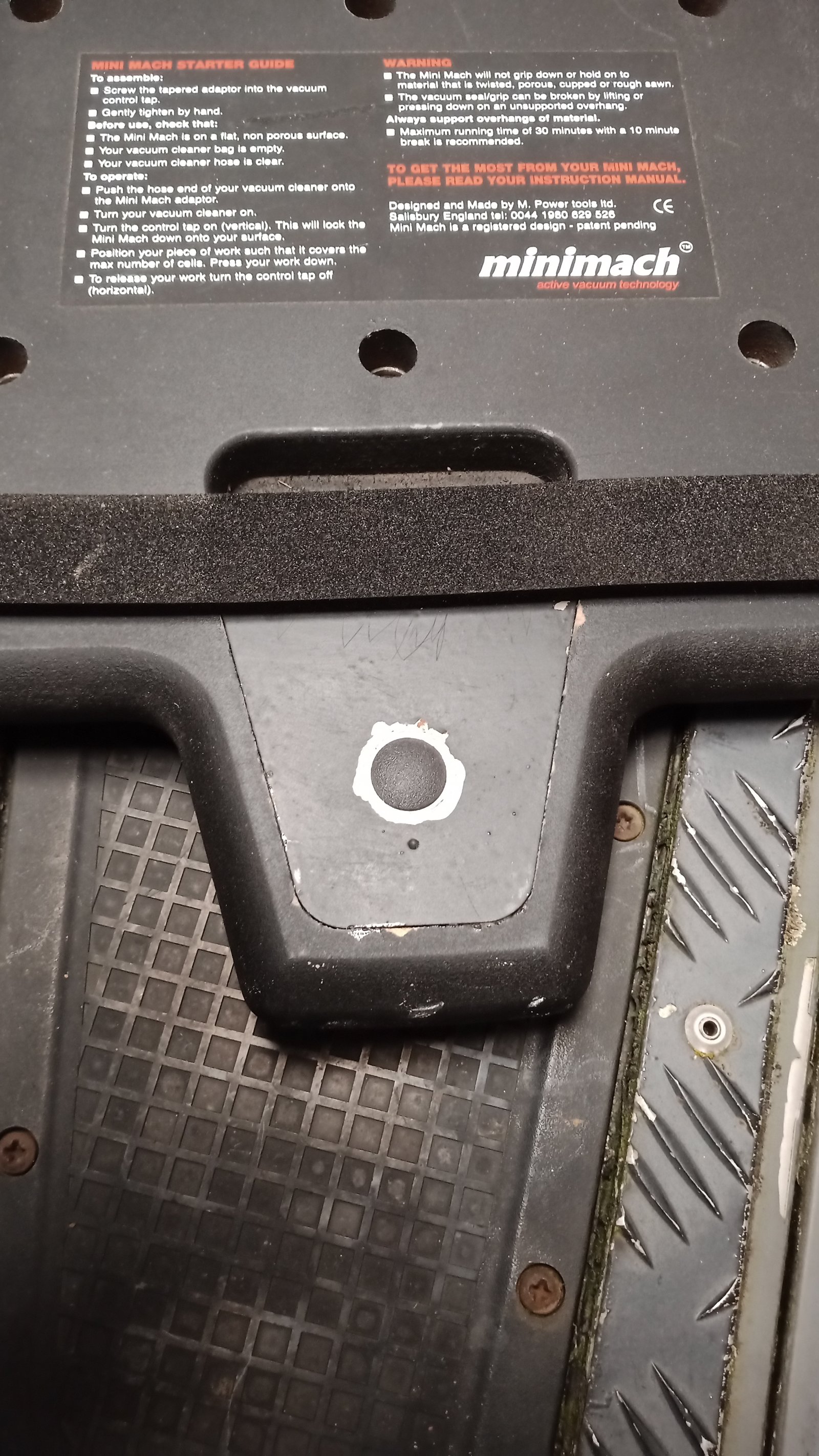

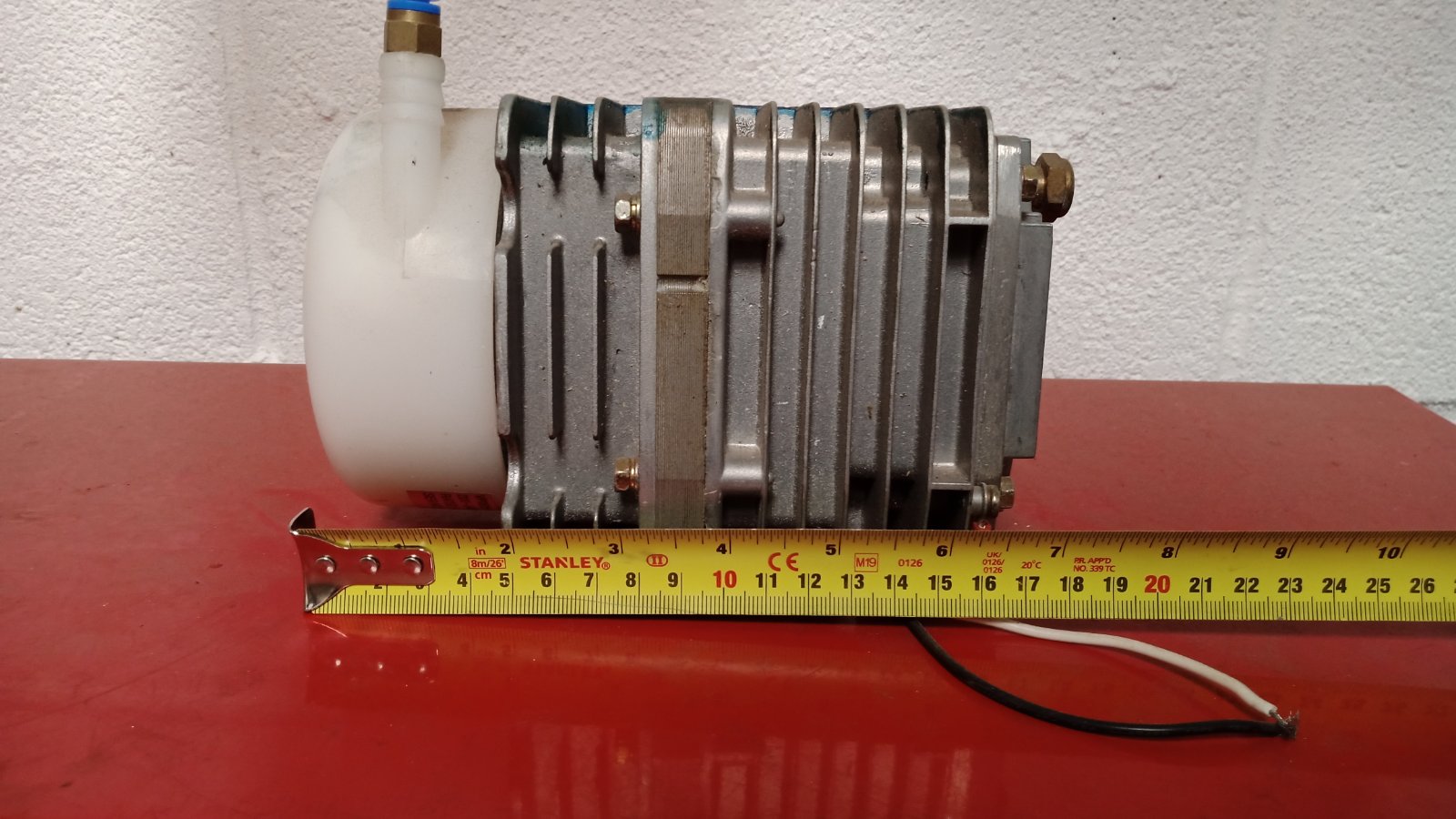

Some pics of the bed and the pump. If you look up the specs and try and get something along the same lines. The white plastic section on the pump houses a foam filter.

On the vacuum front, you just need to find something that will pull around the 9in Hg,
