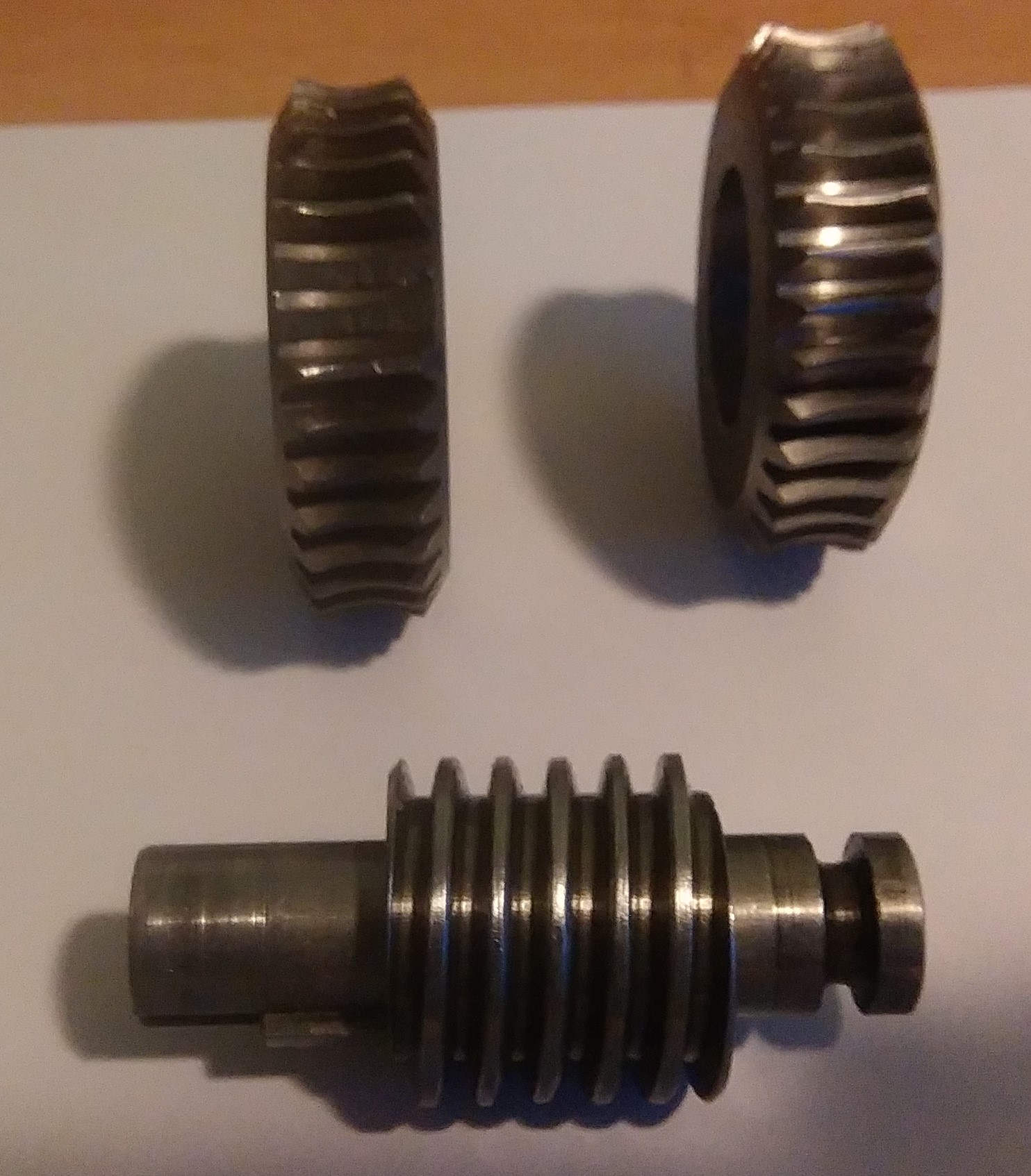

I'd have a damn good go at making one myself first. Grind a bit from HSS or gauge plate and fly-cut the teeth.

Thanks for all the info
I have reassembled the saddle minus the offending parts and the lathe is now back in operation.
I will start sending the drawing out today to get quotes,
hopefully someone will have the correct cutter to do the job in their tool inventory
Re: Apron Removal from a Synchro 280
HPC's quote £108 + VAT + delivery 21 days lead time
steamgeek wrote:HPC's quote £108 + VAT + delivery 21 days lead time
Ouch!
Mind you I was expecting more. Try putting a wanted ad on somewhere like Homeworkshop or Madmodder and see if someone can do better.

Quick update:
New gear being made via a friend in a model engineering society, should be done by this weekend.
Apparently the new blank came out of a 4" round of cast iron - only material in stock and it was in the scrap bin.
He has also taken the worm gear to redress , so hopefully by the weekend I will not have to pull up the power feed lever
and wonder why the carriage is not moving

New part received, and worm was reconditioned
Fitting on Monday, fingers etc firmly crossed
Gearbox is back together and functioning
FYI: I also found another person who would have made the part, John Ward at Lathespares.co.uk and he quoted £35, he told me he had made some previously
Thanks for all the info and tips
