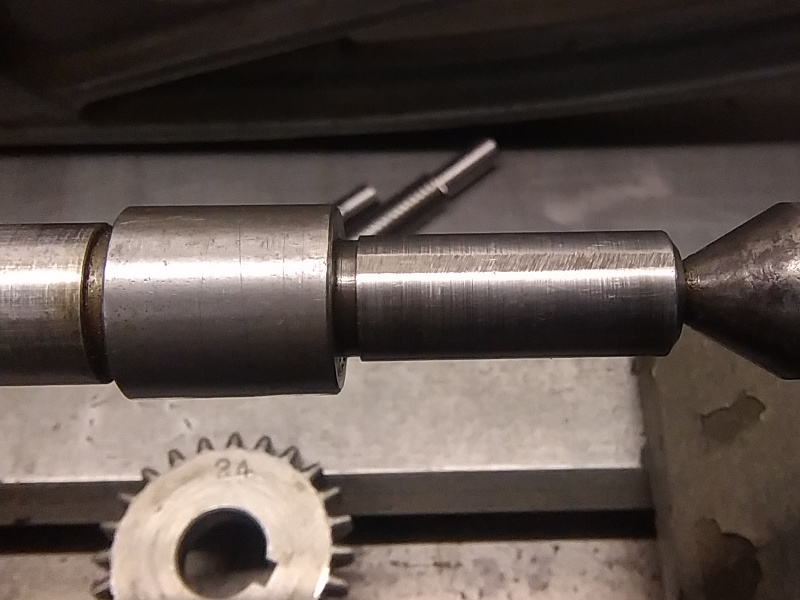

by Pete.
I put my cluster shaft between centres and it's good. As you can see, the filed flat is a factory feature. I guess they must have had apprentices doing the touch-ups.

by Stucapri170
Great thanks Pete much appreciated .. I have PM'd you with what I require was looking at the other shaft , The 3 position selector lever one ,the taper pin hole has been knarled and drilled at some point . If you have that one as well that would be great ..
