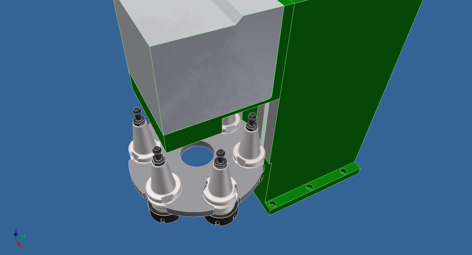

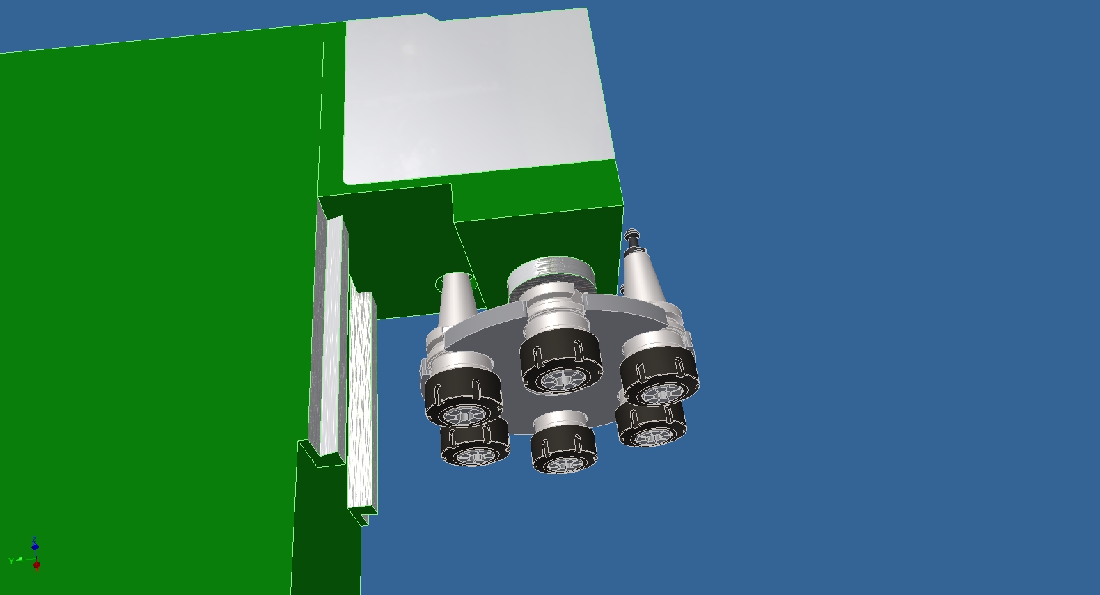

I can't be triac atc style, as you can see in the pictures the tool carousel uses the hole underneath the milling head for the next Tool, so it's impossible for the carousel to go sideways until the head has moved up or the carousel down...
It can still be the carousel that moves up & Down instead of the head...
/Morten

nice model mortenl, fancy sharing?
it could be done in the triac style, would need to be fairly humongous though. don't write it off just yet, it could still be a possibility.
