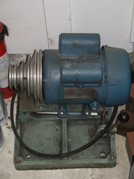

Re: My new viceroy lathe
The motor with both cast iron mounts should come out. There is a bolt in each corner of the lower castings.
Here is a photo of mine. Note the motor is rotated 90 degrees from its normal position.

Dazz
that looks different to mine...and i have random holes in the floor of the cabinet. I fear it may have been altered slightly.
