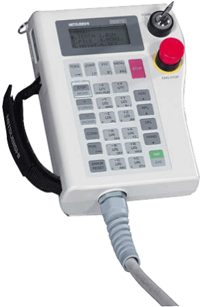

there is no NST button on it
Re: Robotic arm RV 2AJ S12 Issue
I have not heard ot the Robo Explorer Program.
The NST button is on the RV-M1 teach pendant.
RV-M1 Teach Pendant.JPG (15.4 KiB) Viewed 98557 times
I could'nt find roboexplorer program I Just have robo comm
Teach Pendant attached to robots are similar to picture I just uploaded
Whats different control of this teach Pendant and your uploaded teach pendant?
Your teach pendant is for the RV-2AJ Robot, the one i up loaded is for the older RV-M1 Robot
