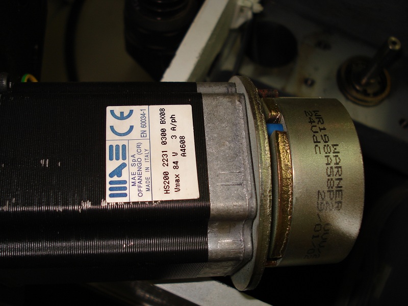

Can you post a picture of the motor. We have fitted brakes before but I can't remember on on a Triton.

I am posting the pictures of the motor.
Re: Routine Problem
It does have a brake.
It's the brass unit sat on top of the stepper motor.
If you remove the brake from the motor you can check the stepper motor then go back & check the brake. It is a 24 volts DC unit & will be locked until power is applied.

I removed the break and tried to move the z axis. Even without the break the motor didn´t run.
It only makes a shrill noise. After removing the break I am able to rotate the motor by hand.
Re: Routine Problem
Try to eleminate the stepper driver or the motor wires/motor by swapping the X axis with the Z axis.
If the Z motor now runs (from jogging the X axis) then the driver is at fault.
If the problem remains on the Z then the motor or wiring is faulty.
