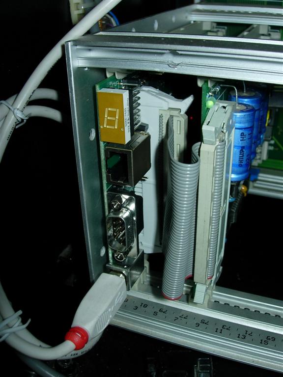

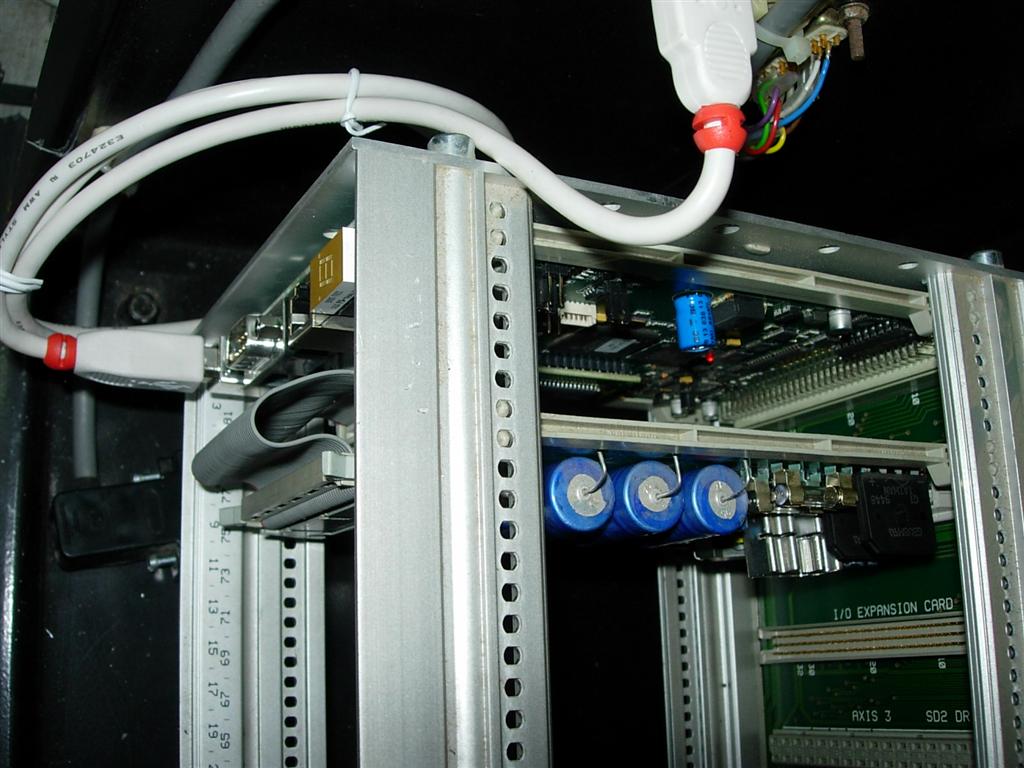

I have similar problem with my VMC Triac. I made upgrade UGR 0007 my machine eight months ago.
My machine worked very well, but a few days ago something was happened that PC computer can't connect with machine.
The machine had no collision and nothing like it.
When I tried to reinstall USB card system Windows XP informed me that he doesn't recognize the device (unknown device).
All different attempts of the installation ended with the failure.
After turning the machine on USB card light yellow, red and orange led diodes.
On display led no light any segment.
I checked voltages after taking the card out and all are correct.
After putting the card into machine voltage +5v drop on + 1.5v and chip CY7C64713 it is getting very hot.
I have second old card Mint, which I put into machine to check machine.
It turn out that everything is OK. This is why I think that the USB card was demaged. What should I do in this situation? Have I got quarantee for this card?

Re: Help VMC TRIAC
1. Where are you based?
2. Have you got the serial No of the Euro card ?
Re: Help VMC TRIAC
1.I am from Poland.
2. S/N Euro card - U1010140093
Re: Help VMC TRIAC
I believe Graham is replacing the card under warranty for you now

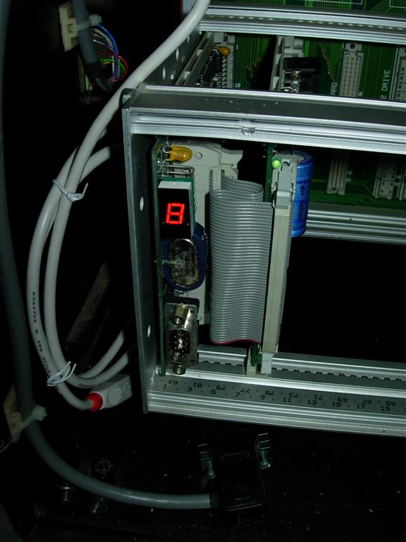

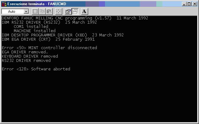

My school has finally decided to buy the card.
I installed it yesterday and her 7-segment LED light with a nice 8, I was hoping it was all ok but when I tried to run in software I wrote the error in the image.
Any idea? I tried changing the file fanucmd.go but without success.
Re: Help VMC TRIAC
Make sure the card has the correct Dos Eprom fitted & not a VRMilling Eprom. It may be easier to replace the Eprom with the original one from the faulty card.
Re: Help VMC TRIAC
Hi. Are you running DOS software?
Can you check the version number on the EPROM on the new card and compare it with the version on the old one.
If they are different try switching the EPROMs over.
Re: Help VMC TRIAC
Hi and thanks for the quick responses.
On the old card's written MINT/3.28 v1.05c/S.
On the new card's written denMINT v2.1.b6.
I think that the old eprom is the reason why the card did not work.
If I put the Eprom in old card risk something new?
Re: Help VMC TRIAC
Can I replace the software dos with that right?
Re: Help VMC TRIAC
It is unusual for a Eprom to fail. I would try the original Eprom in the new card.
Re: Help VMC TRIAC
It seems like the eurocard has been sent with the 2.1 chip installed - this only works with VR milling software (windows based PC)
You must put the Mint 3.28 EPROM in from the original card for the DOS fanucmd software to work with it.

I tried to exchange the ECU but I get the same error <50> Mint controller disconnetted
there seems to be an error when loading the driver for RS232. :( :?
Re: Help VMC TRIAC
Does the 7-segment LED light up ok now ?
Maybe the RS232 connections have been disturbed and broken - can you check the cable from PC to 9-way going into the Euro-card as this post:
viewtopic.php?t=544
Maybe the old card has damaged the PC's serial port...you could try swapping the RS232 around with the tutor keypad.
However, you will need to alter the configuration file FanucMD.go
If you can post this file on here we should be able to advise what would need altering.
Relevant info to changing which port the fanucmd software uses is here:
viewtopic.php?t=1084
