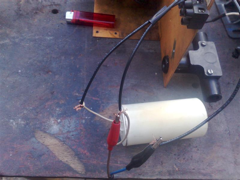

HI pete thanks for this i have got it all working now! forward and reverse all working and the little problem of when i turned the drum for forward and reverse power was coming on! I had put the copper strips and spring upside down ( it fell out when i was putting everything back ) now for the best bit i still have my motor 330/240v 3ph + i have a one off my old boxford lathe the same 330/240v . I have play about with this with a capacitor and have got it stating up and running with lots of torque when i power up still wired in star!? i will post what i do next! ( anyone who is going to do this read what pete has said and take note. and lots of photo's) very easy to get yourself in a mess!!!!!!!!!!!!!!!!!!!!!!!!!!!!!!!!!!!

You're using the boxford motor as an idler for a rotary converter, and startin it on 240V with a capacitor?
