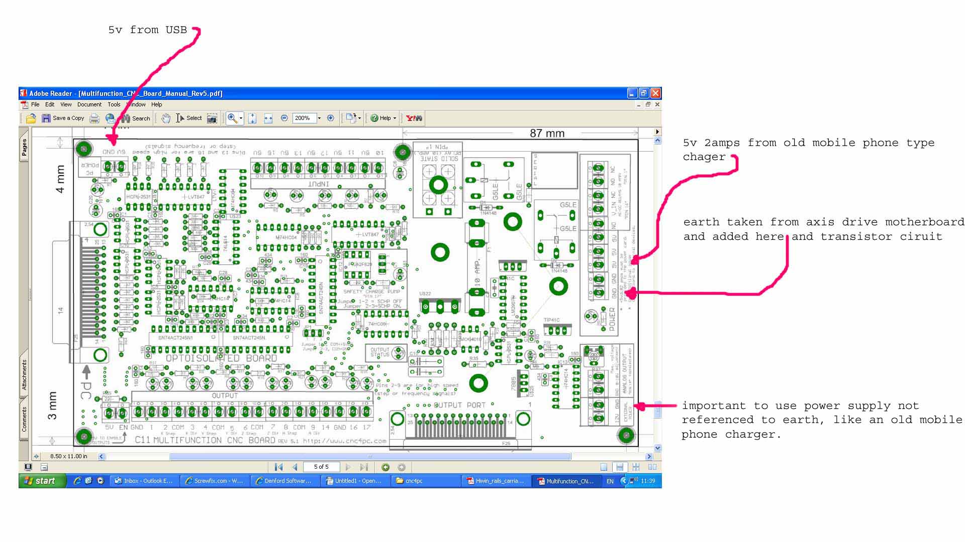

Hi basher, I've uploaded Wiring of my BOB.
BOB wiring layout.jpg (266.97 KiB) Viewed 52502 times

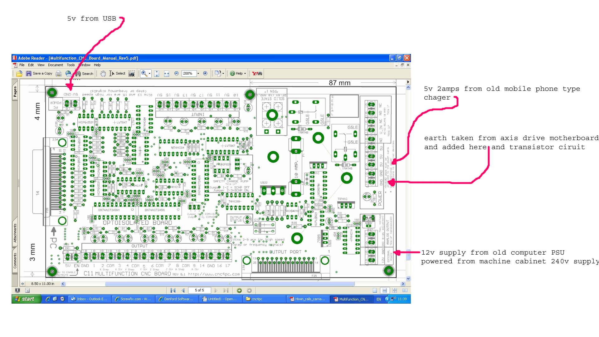

ok Dale i think the problem is the fact your using a pc power suppy for the 12v , ( presume your using the ground from the power supply to the same gnd terminal next to the 12v of course and no where else )
another problem is pc supplys are switch mode so by virtue of they way they work they are not totaly isolated from the mains
so you will find that a pc power supply does not have a floating gnd they usualy tie it to the case as earth in some cases .
you need a straight forward standard el cheapo transformer power supply , bridge and a smoothing cap giving you 12v , a 12v wall wart type will even do , or vist Maplins etc
just make sure the connections are to that 12v block both gnd & 12v
and no where else and you should be fine ,
the fact that it works if you use a battery is proving the point that it's the power supply grounding the half mains voltage
iv'e just looked at the bob board you have and it should do the trick
apart from the notice warning over a seperate isolated power supply must be used , hence your problem
Dave

Spindle now running under full control of Mach. Thanks to everyone and to basher for your help pin pointing the problem. I've upload modified jpeg of BOB wiring just to help anyone following the thread. Next job is to tidy all my cables into the machine cabinet. Next on my list is to buy a license for Mach, then I'll upload some video on youtube showing off my new axis speeds. Only two jobs left, limits and homing switches, and tool release from spindle. Which I plan just operating from a switch manually placed somewhere inside the machine. I'll take a wee breaking for now, as the last three or four weeks have been all about this machine.
BOB wiring layout corrected.jpg (218.72 KiB) Viewed 52586 times

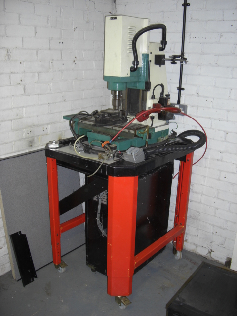

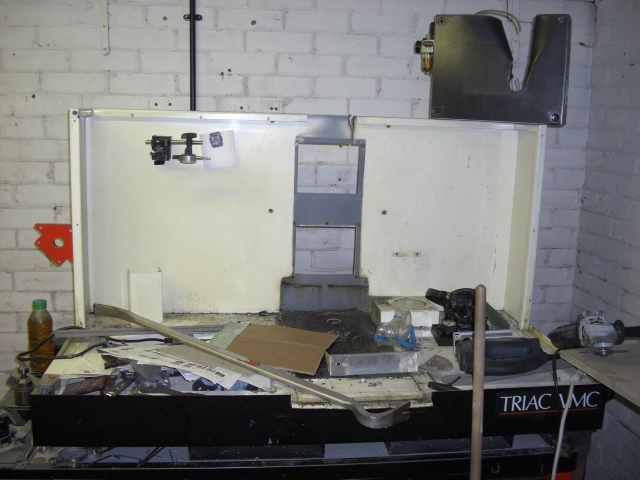

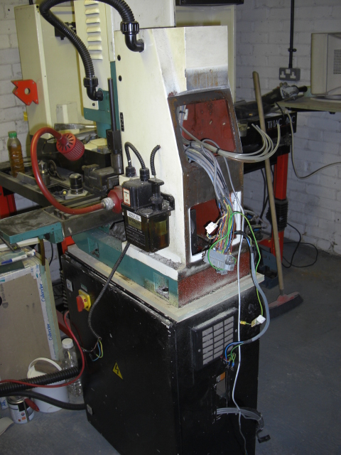

Just an update of where I'm up to on my conversion, I've uploaded some photos on the separation of the mill from the machine cabinet. I've done this to save space. Next on the to do list is weld up a small table to house the mill, electrical cabinet, computer and monitor. I've removed the tool changer as this will be done manually for now, but I am undecided on whether I'm going to use air draw bar or make a manual lever.
Machine on top of electrical cabinet.
Machine cabinet
Machine cabinet
Back of machine
Back of machine
Nearly finished

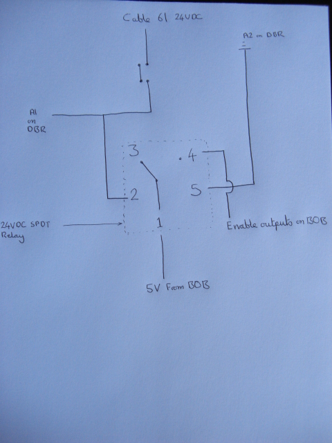

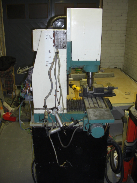

Hi, another update and a request for help. I've uploaded a pic of the mill free from the old machine cabinet and a reduced work bench. I am very happy with the space I have saved :lol: . I have also got the tool draw bar to work from a switch which I have mounted under the machine cabinet, and have incorporated a small safety feature using a 24vdc relay to disable outputs on BOB when draw bar is active (see photo).

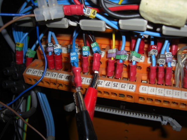

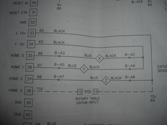

My request for help is on the matter regarding the datum sensors, I have managed to trace the cables from the wiring diagram (see photo) and have done a resistance test on x axis sensor, all is fine. The diagram indicates 12v @ cable 65 going to the sensor and returning via cable 66, the problem is that there is no voltage at cable 65. So next I added 9v supply from another old mobile phone type charger and placed a piece of metal in front of the sensor and noticed a 0.5v increase. Does anybody no a way of wiring and configuring this type of sensor to Mach's 5v I/O?
I am planning of leaving the mechanical limit switch's as they are. As when they are switched power is cut to all drives, Mach will still carry on running through the program, but the machine will be in a safe state. Any information would be gratefully received

Mill on cut down bench
Mill on cut down bench.JPG (212.78 KiB) Viewed 52461 times
wiring for DBR.JPG (186.87 KiB) Viewed 52461 times
wiring for datum sensors.JPG (147.39 KiB) Viewed 52461 times
connections for x datum sensor.JPG (250.74 KiB) Viewed 52461 times
If I've understood your question....
If you've still got 12V in there, then drive a 12v relay from the sensor (thats what we've done when we mess up and get the wrong type (PNP or NPN) and need to change the inputs normal state.
This relay can switch the Mach input to gnd (or +5v - whichever?)

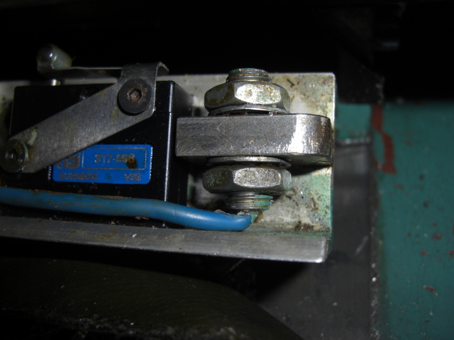

I replaced all the datum switches with micro switches, it was a little tricky as space was tight, but it made for simple wiring as I used the 5v from the output on the BOB and picked up the wiring from the 50 way interface RS board in the machine cabinet. I'll take some video and post to youtube in the near future. Thanks for everybody's help with this conversion :lol:

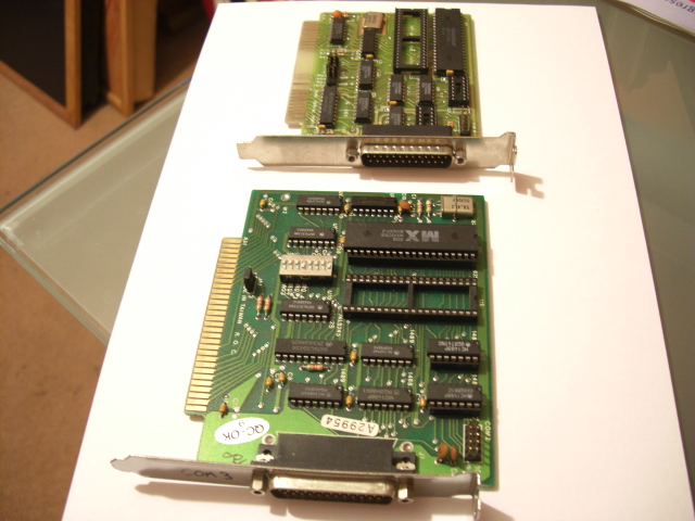

Here are some bits left over from my conversion if anyone whats them I'll ship them just to cover the cost of posting and packing, paypal prefered. If you have read this thread you will understand these parts have been removed from a denford with noise problems so I can not guarantee if there are fully working. They might just keep an old machine going for a bit longer.

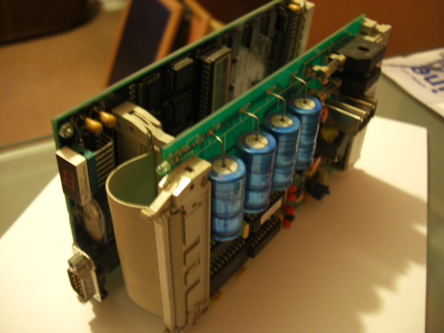

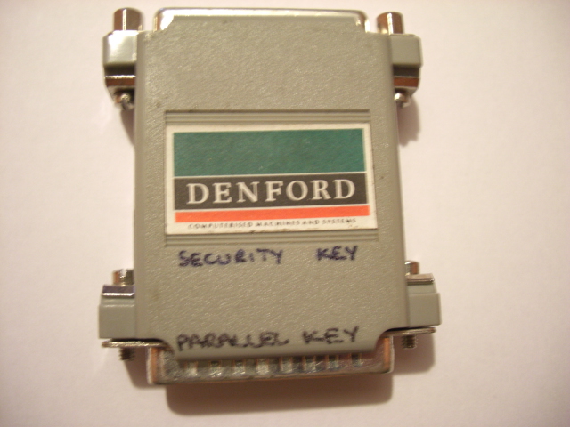

security key
security key
parallel cards
parallel cards
Hi Dale
I am interested in the EPROM and the two cards. (Mint & Costum Card)
Does your offer still stand?
Best wishes
Enny
