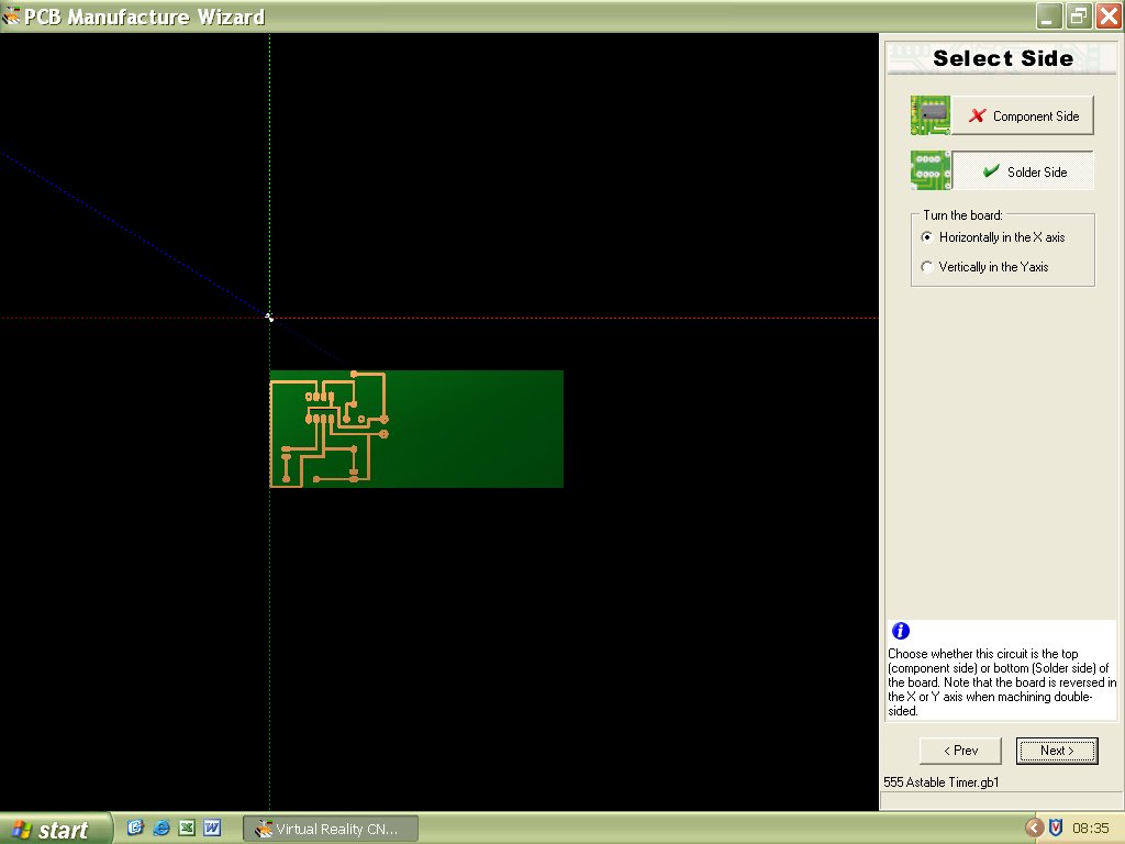

In the tutorial, when a gerber file is imported into VR Milling v5, the board and PCB artwork appear at the same location with the origin drawn in the bottom left corner. However, when I import the astable circuit gerber file (as suggested in the tutorial) the PCB artwork is below the board with the origin drawn at the bottom left corner of the board. When I press Auto Size the board shifts and more than covers the artwork. However, the origin does not shift and the board is now twice the size of the artwork.

I attach two pictures. Screen1 shows the astable circuit gerber file when it is first imported. Screen2 shows what the screen looks like after pressing Auto Size and selecting Solder Side.

From the two replies that I have had, it sounds like I need to alter the origin of the PCB in Circuit Wizard before exporting to gerber. I don't know how to do this as I have not created a PCB from scratch in this package but am just exporting an example circuit.
That's definitely what you need to do...unfortunately none of us have Circuit Wizard, so I'd ask New Wave Concepts: https://www.new-wave-concepts.com

The problem is your PCB is not positioned correctly in relation to the drawing origin.
I have PCB Wizard which is an older version and the Astable exports OK without having to relocate.
Within the PCB software i would first of all copy and rename the example so you dont lose it for good.
Then open the new file. You will have to then unprotect the file. (I think this is shown in the tutorial).
Once unprotected you can edit and move the design. Go to the view menu and show grid in the artwork view and you should then be able to drag the design to the correct position. You may want to delete the circuit diagram and text from the page and just leave the tracks.
