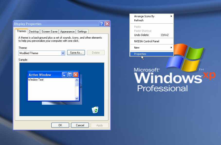

Step 1 Right click on your desktop and select properties.

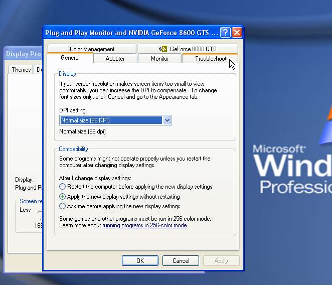

Step 2 Select the settings tab then click the advanced option at the botom right of the window

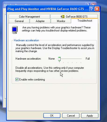

Step 3 Now select the troubleshooting tab and then drag the Graphics hardware acceleration slider to None
Step 4 Now apply the settings and see if the aplication runs.

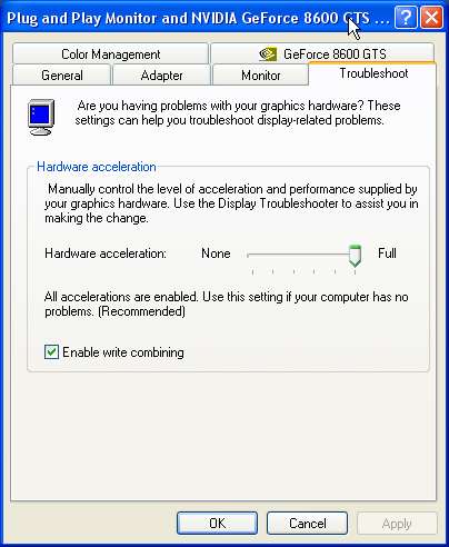

Step 5 If this cures the problem you may repeat step 1 - 3 but dont take the slider all the way to the bottom. At each step on the slider different amounts af accelleration can be selected. Find the best setting that works and save this.
desktop right click.jpg (39.07 KiB) Viewed 22364 times
Advanced Troubleshooting.jpg (51.95 KiB) Viewed 22364 times
full hardware acceleration.jpg (32.86 KiB) Viewed 22364 times
no acceleration.jpg (38.88 KiB) Viewed 22364 times
