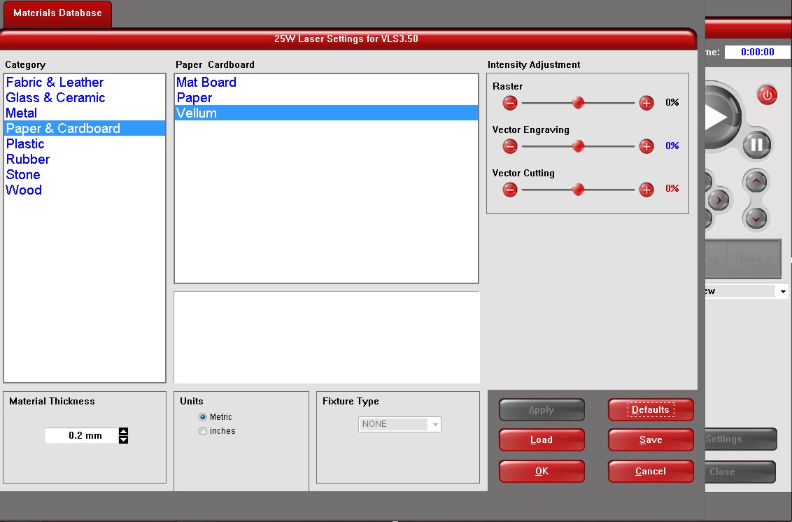

I install 5.27.48 on Windows7 x32bit and is ok, but I have another problem: on Settings don`t apear "Manual Control" tab !
Is necessary to instal another program?

Re: Versalaser on Win7
You need the advanced driver which we do not supply.
When you install the software if you select a bigger laser (VLS 4.60) at the same time as the VLS 3.50 then the advanced driver will be installed automatically. The 4.60 will show up as a printer but is never used.
Martin wrote:When you install the software if you select a bigger laser (VLS 4.60) at the same time as the VLS 3.50 then the advanced driver will be installed automatically. The 4.60 will show up as a printer but is never used.
Thank you - now is ok.
