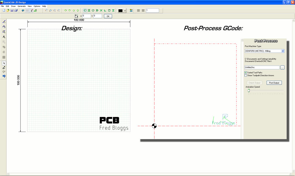

Denford have also provided a package called QuickCAM 2d Design with thier machines over the last 12 - 18 months do you have this?
This package is ideal for engraving and 2 D circuits. You can also import Gerber files into this.
The CAM part of the software would then allow you to engrave text by following a line and machine arround the circuit board parts as well.
in the help there is a sample circuit board and text tutorial.

I think you will have also got a copy of QuickCAM 2D Design ?
If so, you can easily create a template drawing for single-line font engraving and post a G-Code file which can be loaded into the PCB engraver.
